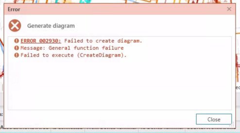

I get an error while generating the network diagrams when I feed the diagram a trace result.
If I run the generate diagram command on a simple selection, everything works, but as soon as I run a trace, like a subnetwork or connected trace, and feed the result to OOB options or custom functions, things start failing with the above error.
Can anyone help me on this?
ChrisUnderwood
Hello @bhaskarsingh1se , in BUG-000168157 it states there is a known limitation when creating a utility network diagram with 50,000+ features from a feature service. Are you exceeding that number of features ? If you select less than 50,000 features, is the diagram created ?
