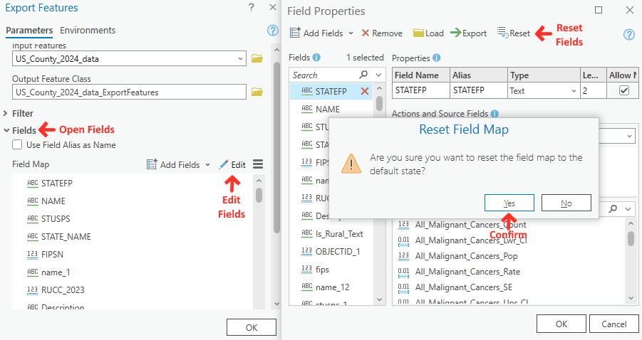

I've been having success exporting joined or previously joined features by adding this step to my workflow to make sure the exported fields are what is currently in the table.

Resetting the field maps worked for me prior to exporting a previously joined table with some records selected.  This workflow is different; is this an expected new workflow or a workaround?

It's just a workaround I noticed resulted in positive results.  Seems like there is a bug in the export form automatically reassessing the fields after joining/removing.  So sometimes the field names either do or don't have the "table.name" format (which isn't how they are named any more) resulting in nulls when the data is copied and those field names aren't found.
