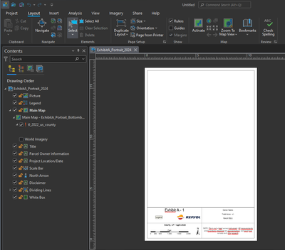

I'm using ArcGIS Pro 3.3.1. Every time I try to open an APRX that was closed on a layout tab, import a layout.pagx., or double click a layout.pagx to open it ArcPro crashes on me.
I thought it was something to do with accessing my data from a NAS but now it's happening on my local drive.
I'm working with ESRI support and my IT department to help but was wondering if anyone else is having this issue as well. Attached is one of the .pagx's I've tried to open.
