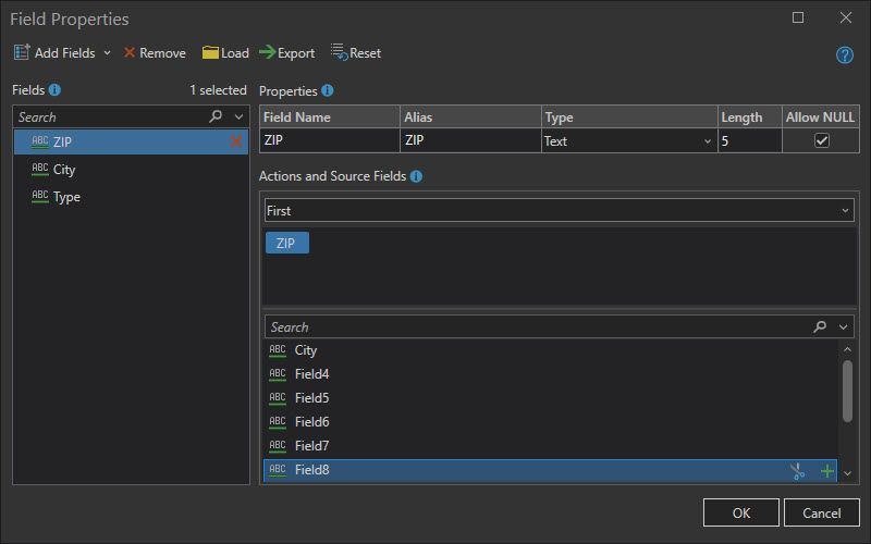

However, in 3.2 when I make those changes, they always revert to the original settings before exporting:
All I'm doing is removing fields and changing ZIP from numeric to text so that I can use it to join as usual:

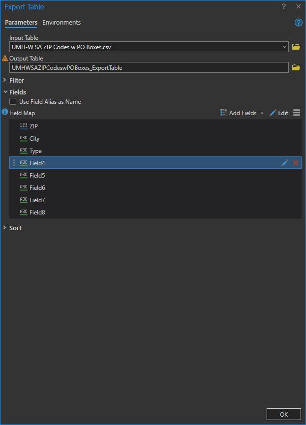

When I hit OK, it reverts back to the first picture.  I've even tried creating new fields with the field type I need, but that doesn't work either; all changes are blown out after hitting OK.  This is really hindering my work and I don't want to have to clean my data before using it since I never had to before.  Any help would be greatly appreciated.

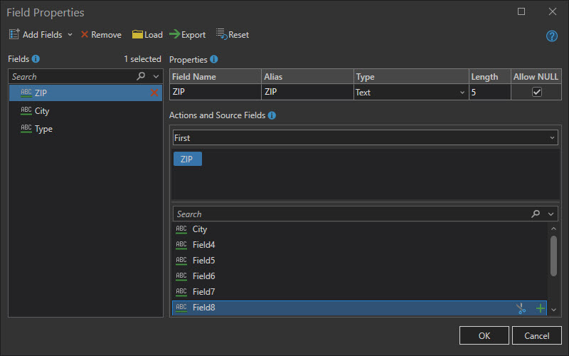

Also, your first pic shows an alert (exclamation point on a yellow-gold warning triangle) by your new file name (and path).  Click on that for the message, and it may point to another solution.  Click on the folder icon to the right of it, and make sure you have a valid path.  I hope these ideas help!
DonNadeau-GISOffice
Also: if your numeric zipcode is "zip+4" a.k.a. nine digits, then you need to re-code your translation to match, with nine rather than the five characters input in your pic.  Or not.  Good luck!
