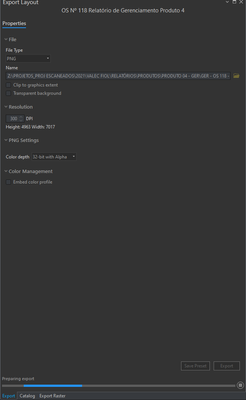

I updated to version 3.1 this morning and have found that I can't export layouts to graphic files when opening projects created in a previous version of ArcGIS Pro. When I try it seems to hang with the message 'preparing export'. If I copy layouts and maps into a new project file they export ok. Has anyone else come across this issue at all so far?

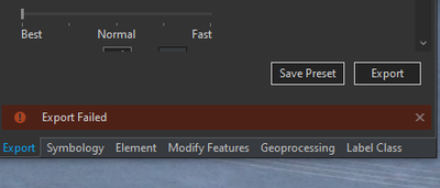

3.1.1 does not seem to have fixed it entirely...getting the simple "export failed" message on a project that was created from scratch in either 3.1 or 3.1.1. No error number, either.

I am having the same problem, when I use the Export Layer to create maps it just runs endlessly and never exports a map. I had version 3.1 and tried the ESRI root folder rename but no success, and I just downloaded the latest patch 3.1.2 and still no success with Export Layer. I have read the suggestion to recreate your entire project from scratch in a new 3.1.2 file instead of just opening the previous file version and saving it in the new version - it would be unfortunate if this is the only solution but I will try it next.

I'm having the same problems, some solution so far, I'm with version 3.1.2. I did a clean install and the problem persists when exporting.

There is BUG-000157970 - "Export layout results in an error "Export failed" using ArcGIS Pro 3.1 and above."  The BUG was fixed at ArcGIS Pro 3.1.2 and a workaround is to use the Print Layout command on the Share tab as an alternative to exporting the layout - this will work for PDF exports.
