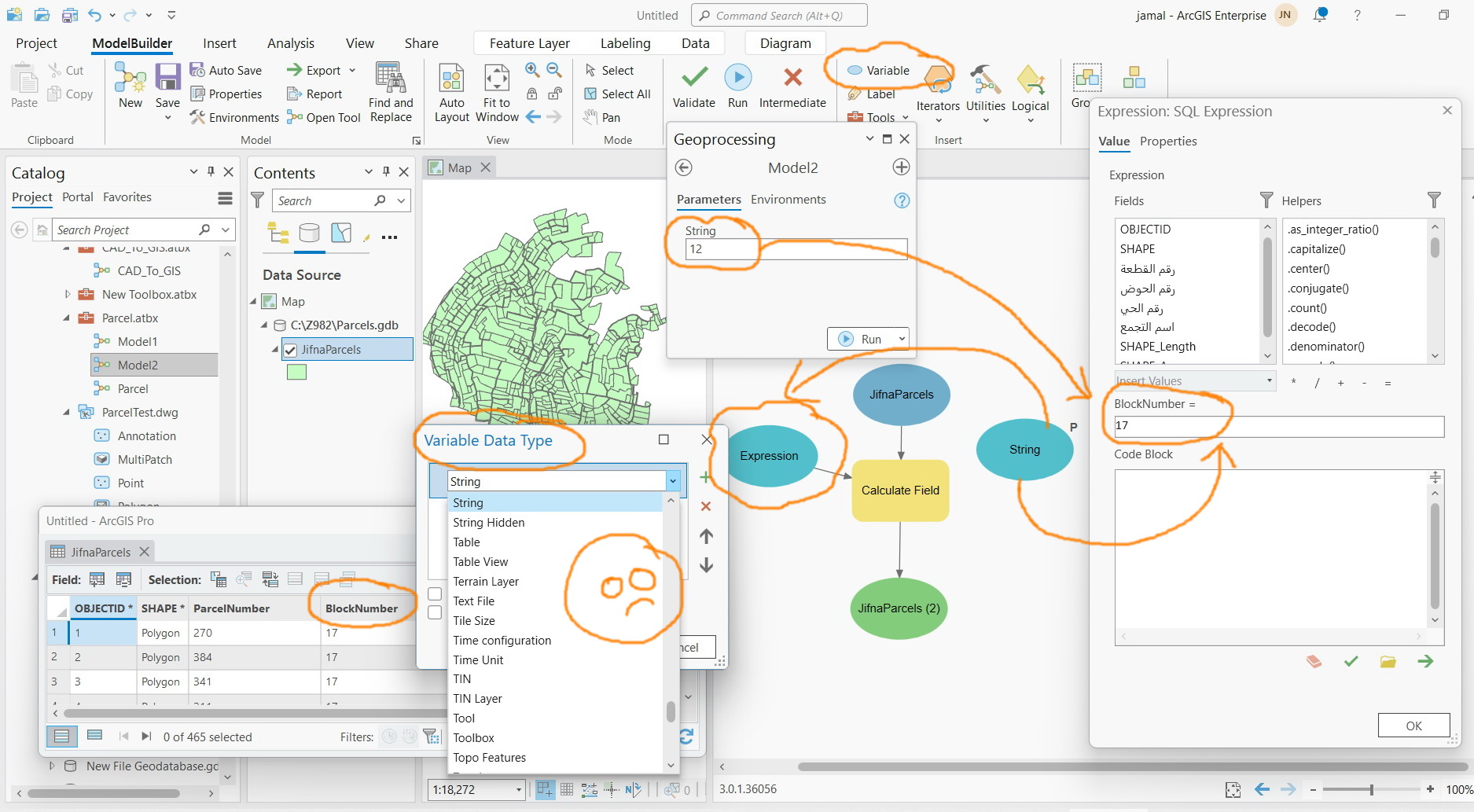

ArcGIS Pro 3.0.2: Which variable in the model builder can be used to pass a value for the “expression” of the “field calculator”?

For example, in the screenshot below, I couldn’t figure out which variable in the model builder can be used to pass a value for the “expression” of the “field calculator”

Hi Jamal, how you doing man?
What are you wanna do? If you intention is change the field  you can use the  function replace in the helpers.
Let me know if I understood wrong.
