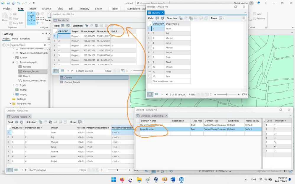

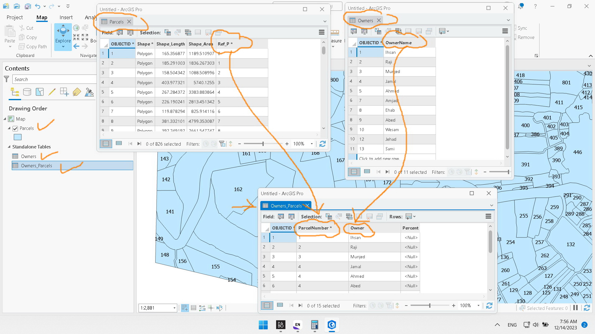

For example, in the screenshot below, I wanted to read the value of the “ParcelNumber” field from the “Ref_P” and the “Owner” from the “OwnerName”.
How this can be managed in ArcGIS Pro?

Hi @JamalNUMAN,
You are looking for relates. We need to define the relationship between the layers: Introduction to joins and relates—ArcGIS Pro | Documentation
From there, you can access this data from the table menu and in pop-ups: View related data—ArcGIS Pro | Documentation

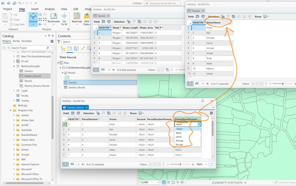

What I wanted here is a dynamic domain that can read its values from fields in other tables as per the screenshots below. Is that still possible?
