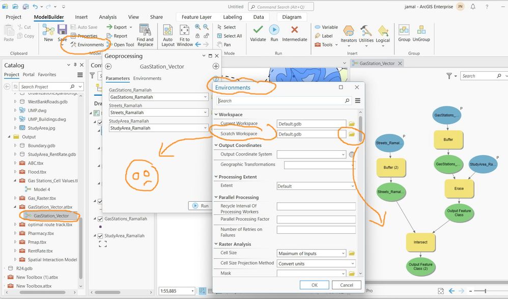

I need the very end user to choose the “scratch workspace” for all the outputs exactly as we do with the environment tool AS PER THE SCREENSHOT BELOW

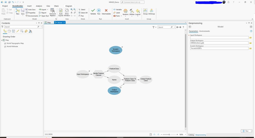

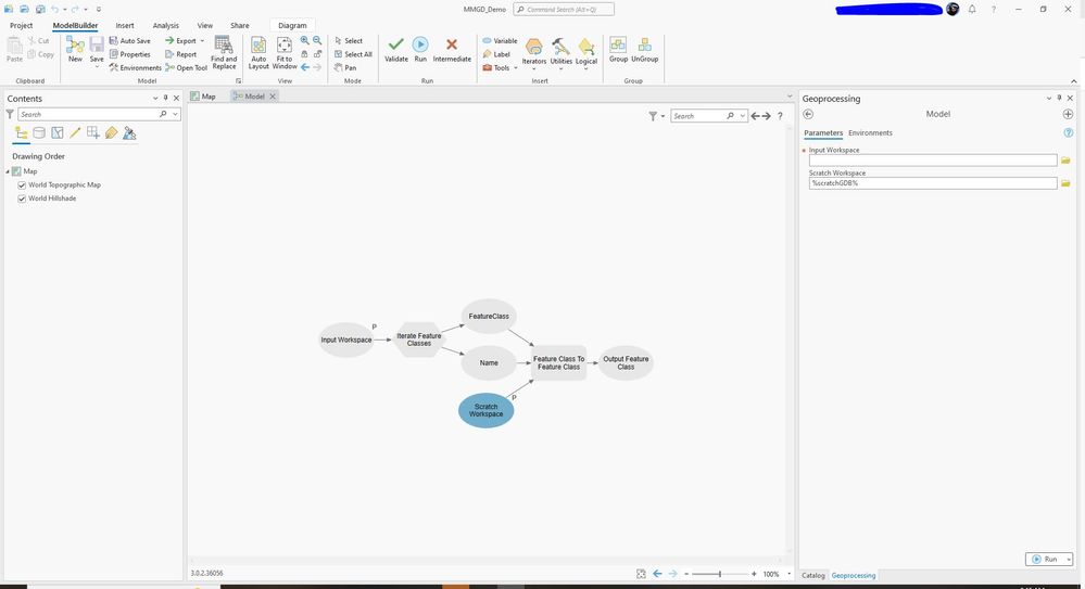

Okay - I understand what you're trying to do now.  I believe I'm getting closer to a solution for you.  In ModelBuilder, I went to the Insert group->Variable and chose "workspace" from the dropdown list.  Then I double clicked the new variable and entered %scratchGDB% and clicked OK.  Next I renamed the variable Scratch Workspace and marked it as parameter.  Saved the model and ran the model.  The result you can see below.

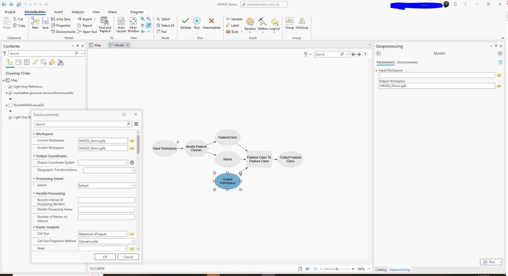

Related, in your graphic I saw are using the Feature Class to Feature Class GP tool, so another thought is to right-click the tool, select create variable->From Environment and choose "Current Workspace".  Then open the blue variable and in the input box, type %scratchGDB%, click OK.  Rename the variable Scratch Workspace.

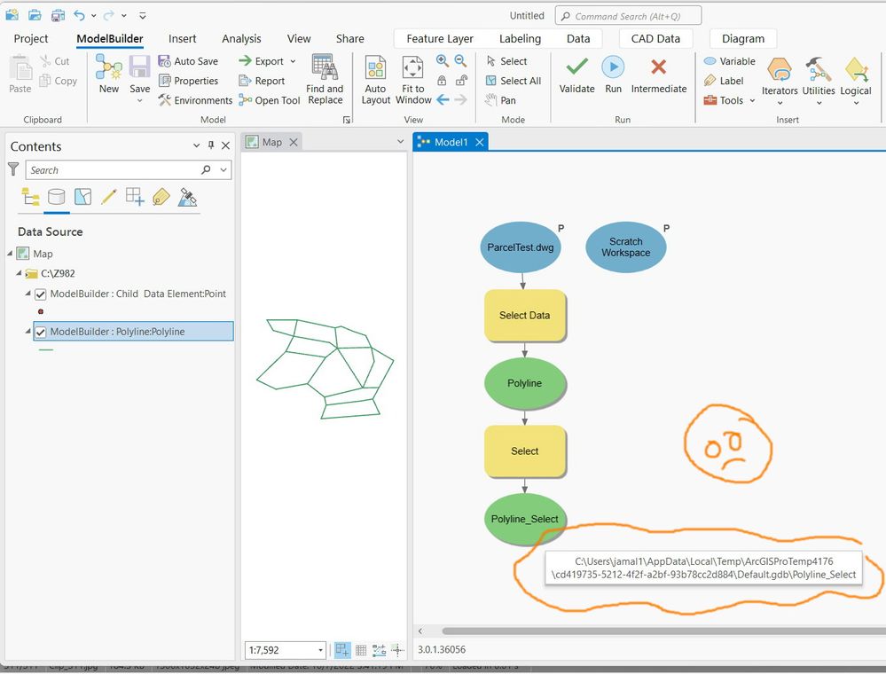

I managed to implement the steps you have already provided. The outputs (green color) in the model appears not to respect the “scratch workspace” set in the “variable”.
