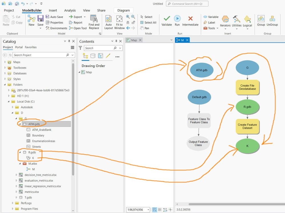

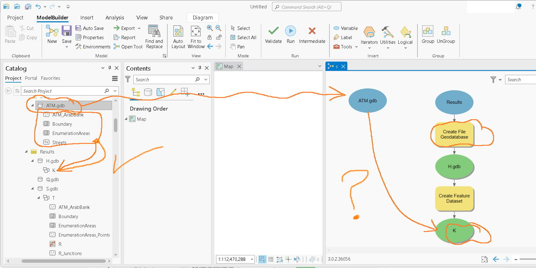

ArcGIS Pro 3.0.2: How to import features classes from file geodatabase into feature dataset in the model builder?
In the screenshot below, I couldn’t figure out how to import features classes from file geodatabase into feature dataset in the model builder.
What could be the best practice in order to perform this?

JamalNUMAN
Legendary Contributor
Many thanks of the help.
I couldn’t figure out how the “feature class to feature class” tool can read from the “ATM.gdb” and write in the K feature dataset.
The data and the model are attached
