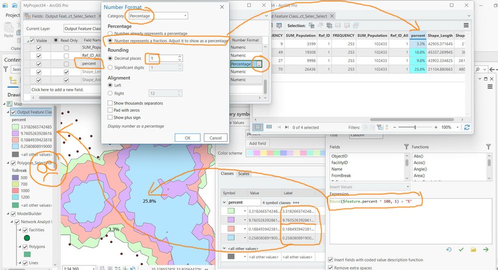

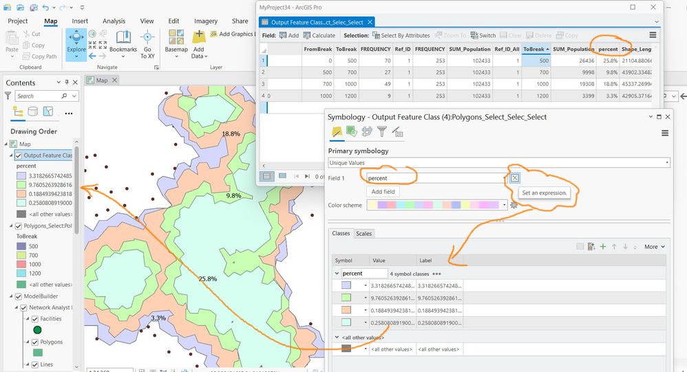

I couldn’t figure out how to display the “percent” field as a percent in labeling and symbology as illustrated in the screenshot below

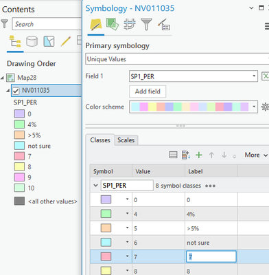

Manually edit the Label column in the Symbology pane to change the appearance of the symbology text in the Contents pane. The values that appear in the Label column in the Symbology pane are the same as those in the Value column by default but it’s actually the Label column that gets used. Double click on a value in the Label column --> overwrite it press Enter. Just about any character is allowed.
Labeling is a bit different and you might try adding a Long integer field if you are OK with no decimals and calculate it to create numbers like 25. Then write an Arcade labeling expression like

Based on your input, I managed to show the percent format for both the label and table.
I’m still wondering if there is still a way to display the percent format in the symbology but not manually.

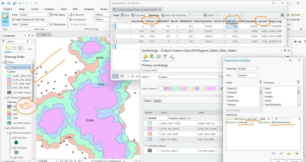

I managed to solve this issue as per the code below
Round ($feature.percent * 100, 1) + "%" + ", " + $feature.ToBreak + ", " +$feature.SUM_Population
