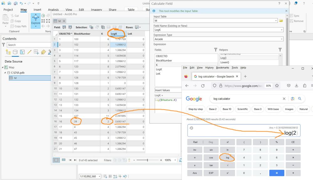

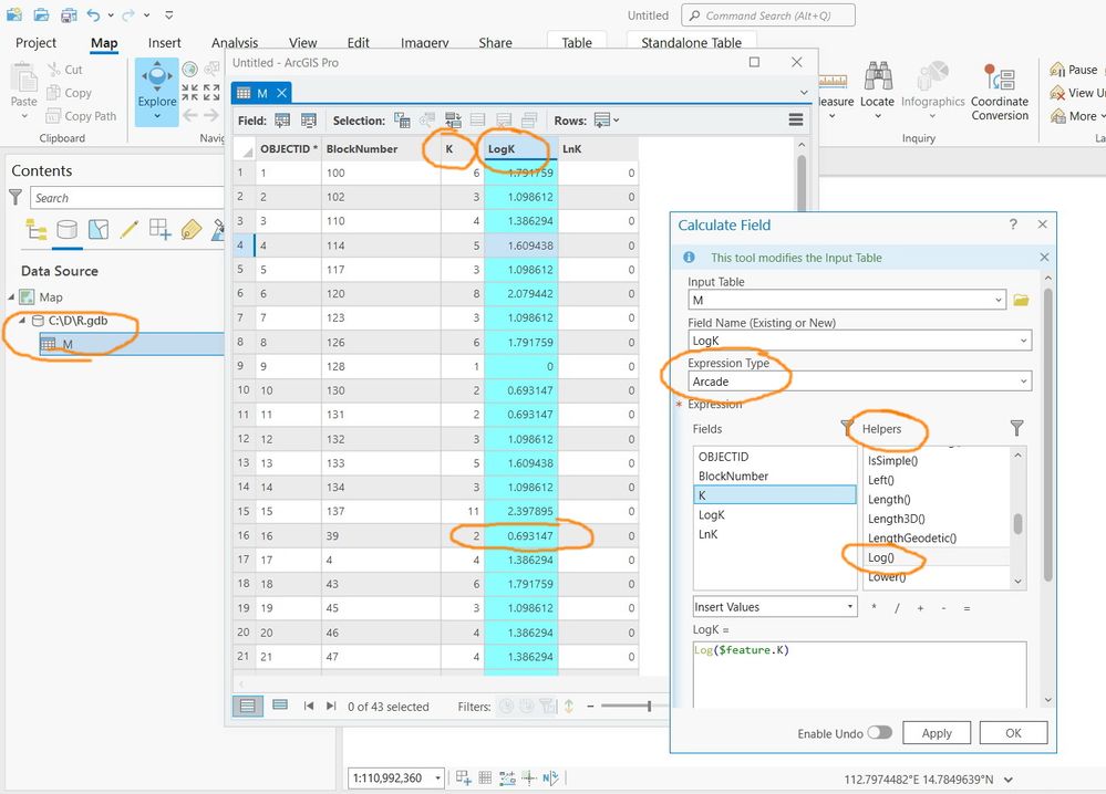

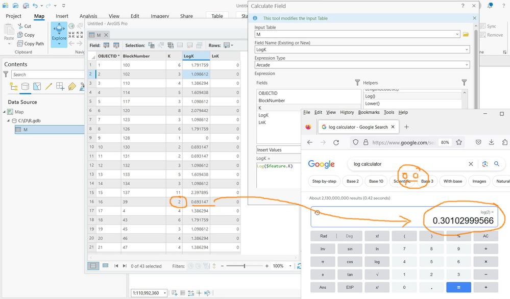

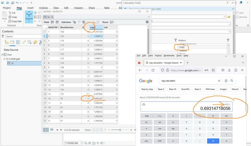

I observed that the Ln(x) is not available in the list of “Helpers”.

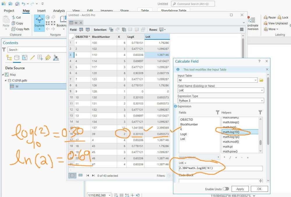

But mathematically, Ln(x) = 2.403 Log(x)
What is shocking is that the Log (x) in Arcade calculates the Ln(x) but not Log(x)
What could be the issue here?

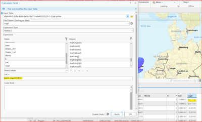

Hi @JamalNUMAN
I would recommend using the Python code for this, it looks like something is missing in the Arcade section and I would suggest raising this with your distributor to have it raised as an enhancement for future releases or raise this within the Esri Ideas page.

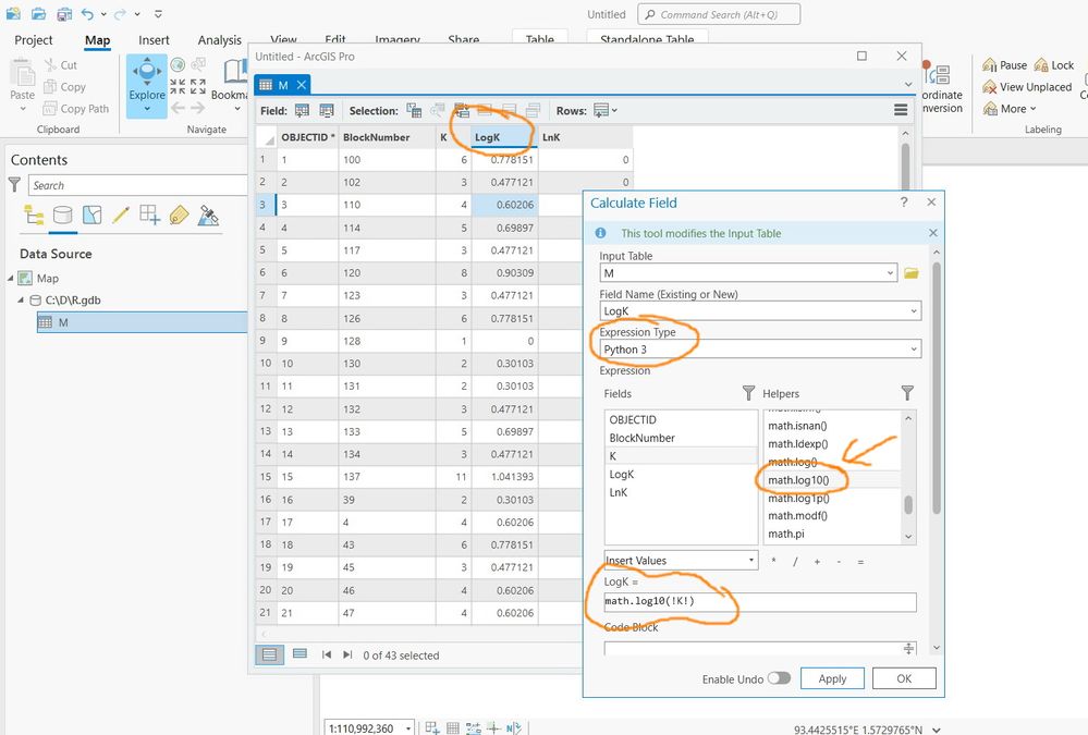

I have noticed that if you use Python and this function it should get you the desired outcome
Using math.log10() gives you a logarithmic value as seen below
If you use math.log() this will perform the inverse log giving you the natural log (Ln)
I hope this has helped.
The Log() expression in Arcade is described to return the following
"Returns the natural logarithm (base E) of a."

This is a difference in conventions between programming and mathematics and is completely expected behavior. In many (if not most) programming languages, log(x) calculates the natural logarithm (base e).
This is also described in the respective documentations. For example:
log in Arcade
log in Python
log in Javascript
log in Java
log in C++
etc...
Have a great day!
Johannes

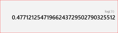

DanPatterson
MVP Esteemed Contributor
or convert from one base to another
ln(x) = log10(x) / log10(e)

JamalNUMAN
Legendary Contributor

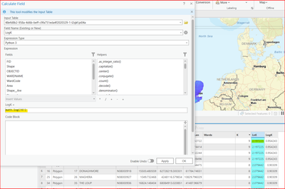

It works fine with the Python as per the screenshots below
