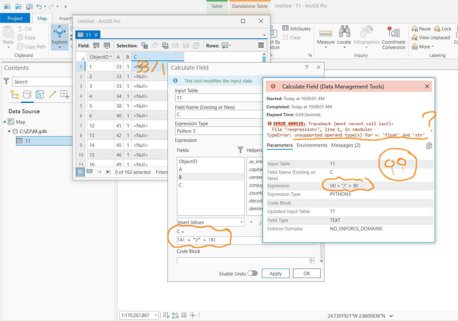

I couldn’t figure out why the python expression below fails to perform on “field calculator
!A! + "/"+ !B!
This expression is supposed to combine the field A and field B in field C. The first value in the C table when computed is assumed to be 33 / 1
What could be the issue here?

Luke_Pinner
MVP Regular Contributor
The error message is telling you that you can't add a string to a number. The "+" operator is for adding numbers or concatenating strings, not adding or concatenating strings to numbers.
Use string formatting instead:
C = f"{!A!} / {!B!}"

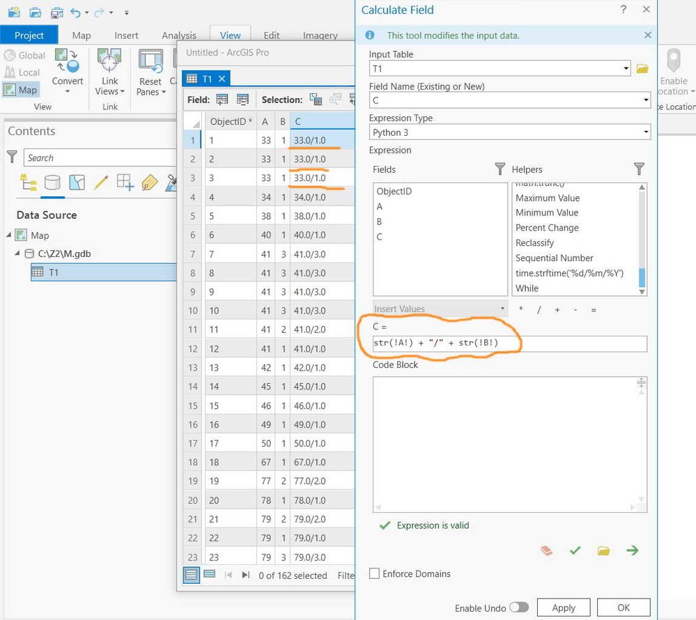

JamalNUMAN
Legendary Contributor
The expression (str(!A!) + "/" + str(!B!)) adds one decimal number for each number.
How to eliminate this decimal number?

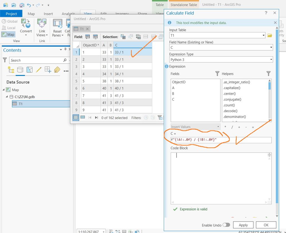

Luke_Pinner
Again, use string formatting
f"{!A!:.0f} / {!B!:.0f}"
"{:.0f} / {:.0f}".format(!A!, !B!)
"%.0f / %.0f" % (!A!, !B!)

JamalNUMAN
Thank you for the help. It works fine
