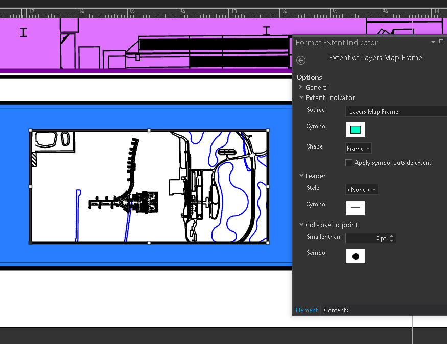

I have a layout with two map/data frames setup in it, I can configure the extent indicators for the small keymap all I want but after screwing with all the options I could find, I still can't get the indicators to show up.  The frame that the extent indicator is pointing to (the source, purple below) is the template for a map series, the idea being to have the extent indicator change as you go through the series sheets, could that be a problem?  Can this even be done in Pro?

AubriOtis
Hi!
If you change the Shape dropdown to Map Series Shape it should show the extent indicator, and update for each page. I hope this helps!

KeithAddison1
Thanks, I wasn't aware of that option.  It didn't help, but I deleted everything and recreated it in a new project and it works now.  Must have been some unknown bug or toggle somewhere in the old version.
