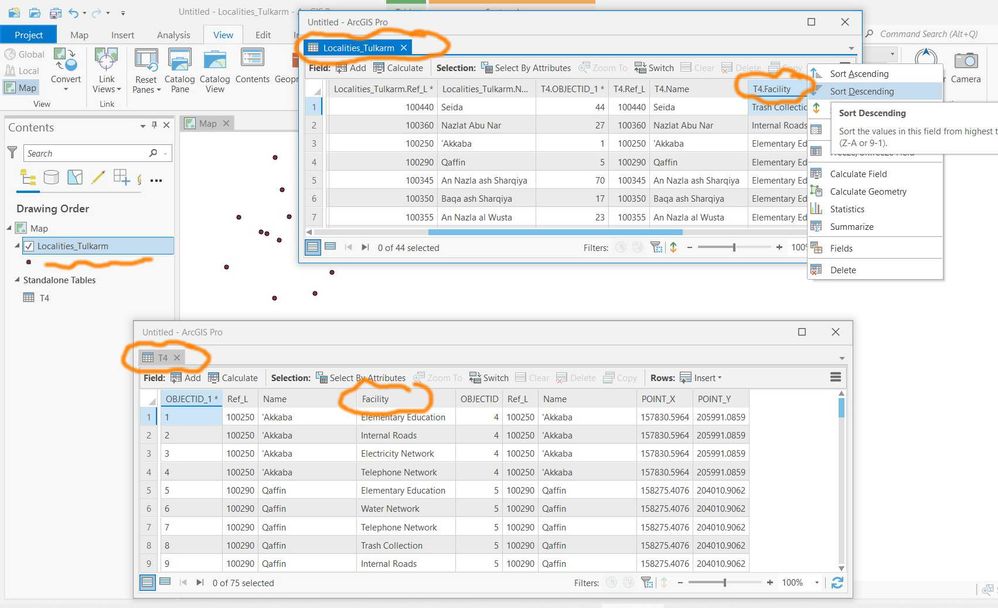

I couldn’t figure out why “sort ascending\descending” tools are deemed for fields that come from the joined table (linked with add join tool).
In the screenshot below, a layer (L1) is joined with a table (T1). The “sort ascending\descending” tools fail to work for fields that belong to the joined table (T1)
Is this by design?

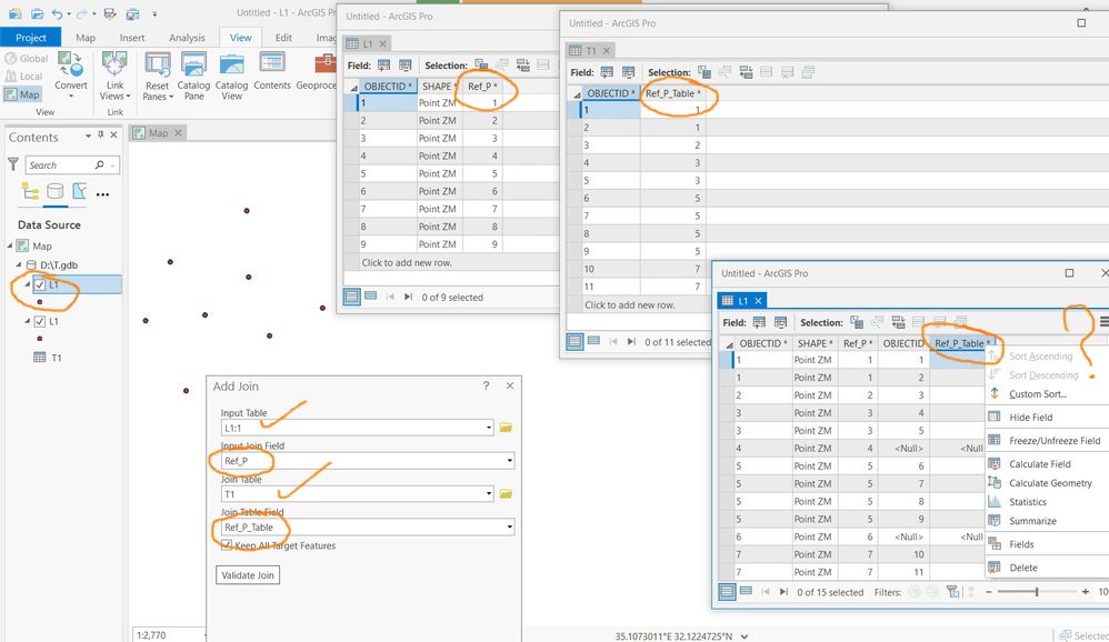

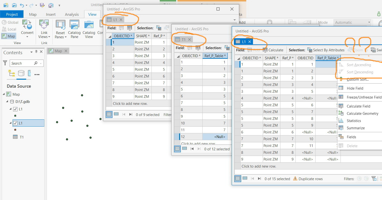

The data is attached.
After getting the layer and table joined as per the screenshot below, the sorting tools will never work for “Ref_P_table”

Thx for the data Jamal - I think this is a bug based upon my testing.
1.  I followed your workflow in a new project and confirmed the sort ascending/sort descending was grayed out - AGP used the "new" Join cardinality of 1:M by default - it seems there's no way to do a traditional 1:1 if the software detects 1:M.
2.  Tested in ArcMap where supported cardinalities for a Join are 1:1 and M:1.  Sort ascending/sort descending worked.
3.  Back in ArcGIS Pro, created a copy of T1 called T2 and removed duplicate records.  Create a traditional 1:1 join and sort ascending/sort descending worked.
4.  Ran the Join Field GP tool on copies of L1 and T1 - tool modified existing L1 data and used 1:1 cardinality I believe.  Sort ascending/sort descending worked.
My belief is that the 1:M cardinality for a Join in ArcGIS Pro 2.7.2 (maybe earlier) is the culprit with the sort ascending/sort descending not working.  I recommend you contact Esri Support Services and log this as a BUG.
