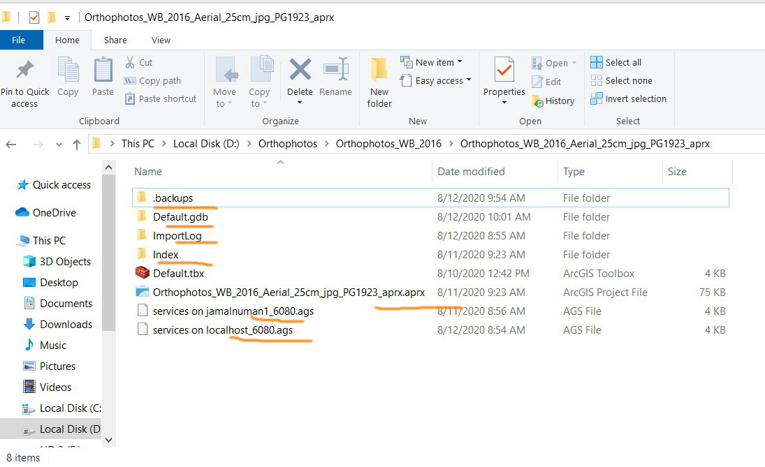

I couldn’t figure out the function of the Index and ImportLog folders that are created along with the aprx

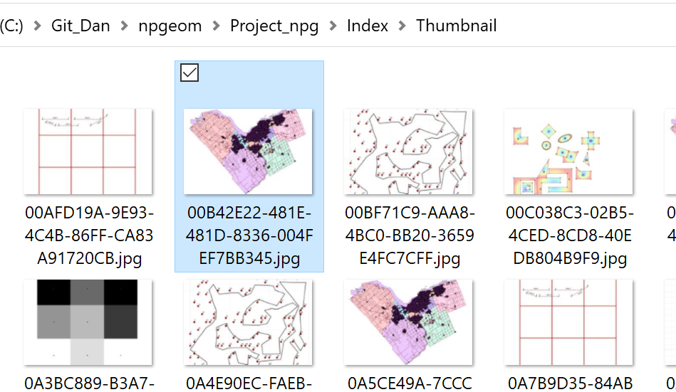

thumbnails of your maps for one... did you look into the folders and see all the weirdly named jpg files?
put your file explorer to view thumbnails rather than list

I observed that multiple files\folders created along with the aprx file. Is there any setting that enable saving in a single aprx file without having any other related files

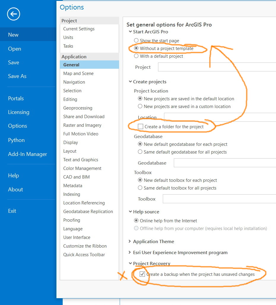

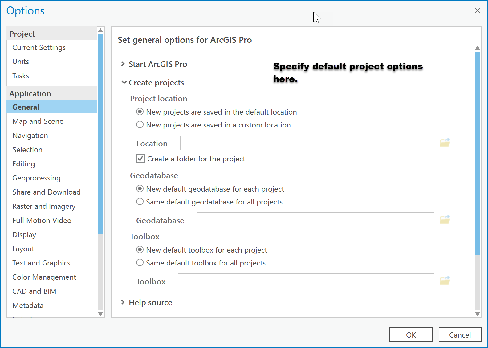

You have some control over auxiliary files but I don't think complete control. Take a look at the General options topic. You can designate one geodatabase and one toolbox as the default for all projects--then you don't have new gdb and tbx files created for each project. You can turn off project recovery--I assume the .backups folder is not created in that case, but haven't tested. You can also turn off indexing--again, I'm not really sure if that means no Index folder is created. (And I'm not sure you want to turn off indexing if you need to search for files.) But that's as much as I know.

What I wanted here is to end up with one single aprx file (mxd of ArcMap is used to be one single file)

But if you don't like that, you can set your application options so that by default your gp outputs are stored in the same geodatabase and your custom tools are stored in the same toolbox. Within a project, you can make any geodatabase the default for that project. You can override the default by sending any tool output to a different geodatabase (or by changing the default). It's flexible, just like ArcMap.

Correct, there is a way to avoid creating gdb or tbx files but it appears that there is no way to avoid creating Index, ImportLog, ags, etc.
Add to this that there is no way to set the “without a project template” option with having an option to uncheck the “create folder for the project” option. In other words, if the “without a project template” option is chose, then the aprx file will be compulsory stored in a folder

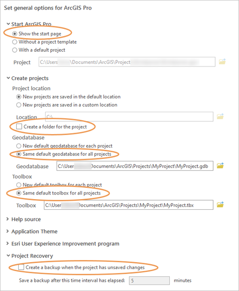

To avoid creating the index folder, go to the Settings page. Click Options > Indexing. Click Don't create index. I'm not sure about the ImportLog folder. When I set options for creating projects to Same default geodatabase for all projects and Same default toolbox for all projects, it seems the ImportLog folder is no longer created. (??) Your .ags files are connection files to ArcGIS servers. They are created if you add a server connection--they are not present by default when you create a project.

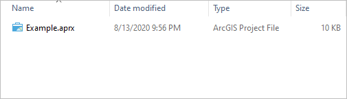

When I create a project from the Map template (or another template) with my options set as below and indexing turned off, I see only an aprx file created and no other files.
Result:
Yes, I think you're right. If you start without a template, and then choose to save the project, a project folder is created automatically.
