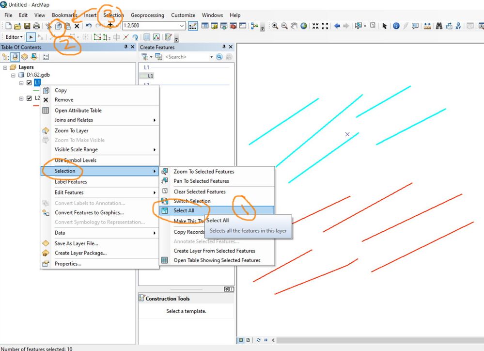

In the screenshot below, all features of a layer are selected and then the copy tool is performed. However, the “paste” tool to get activated.
What could be the issue here? Is this a bug?

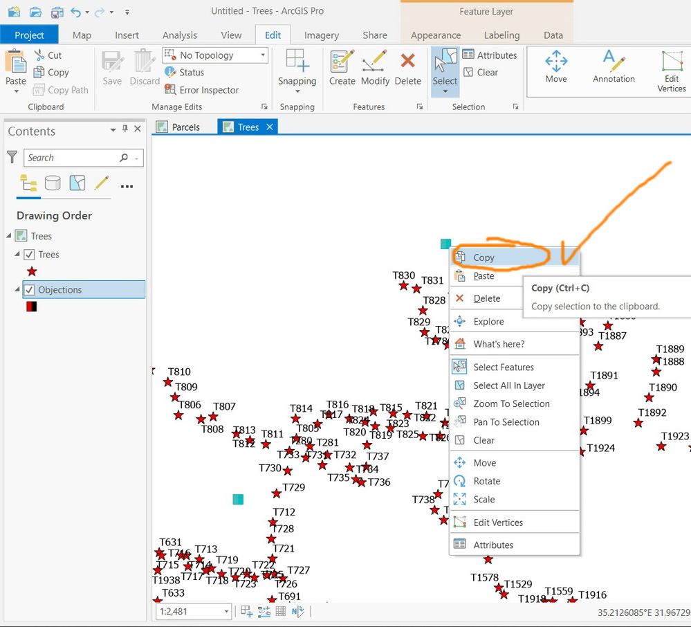

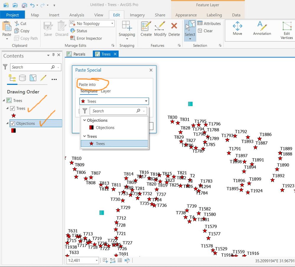

To avoid all this confusion, I observed that if the “copy” tool that is available on the right lick will be understood to copy the features but not the layer! All goes decently with it
