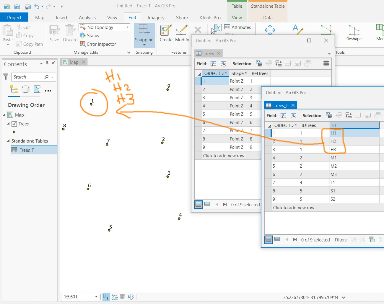

I couldn’t figure out if there is some workaround to label based on relate table (the one I tried is to transfer the xy of the points to the stand-alone table and then to plot it. However, this is not dynamic)

Seems like this question comes up from time to time.  With google I just found:
https://support.esri.com/en/technical-article/000021133
That should just about do it....
