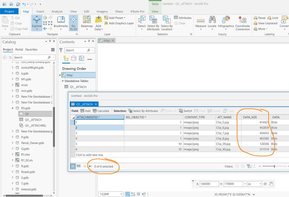

For example, in the screenshot below, the related table contains 6 photos. Then how these photos can be displayed or downloaded from the related table? Where are they physically stored?

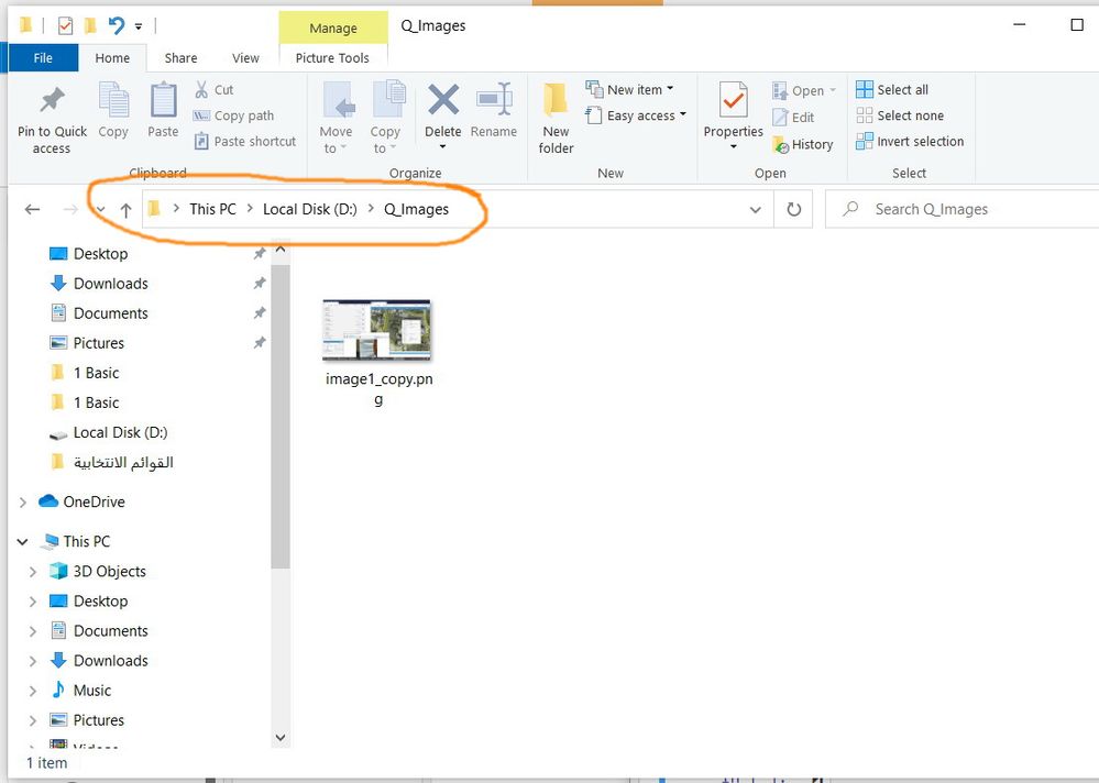

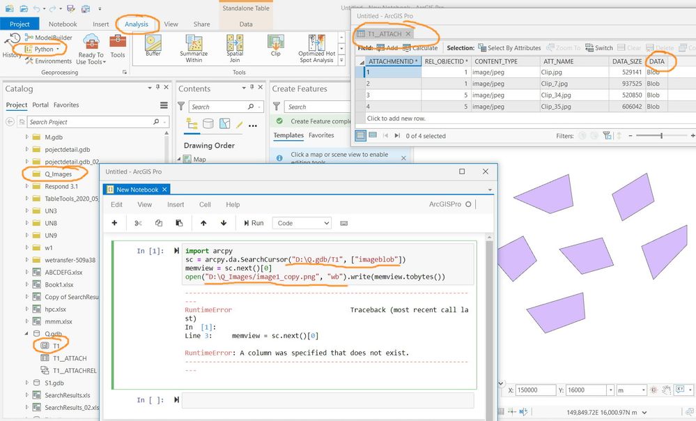

The code below appears not to work as per the screenshot below
import arcpy
sc = arcpy.da.SearchCursor("D:\Q.gdb/T1", ["imageblob"])
memview = sc.next()[0]
open("D:\Q_Images/image1_copy.png", "wb").write(memview.tobytes())

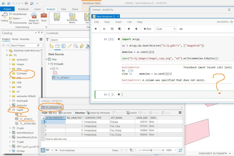

The error persists to exist as per the screenshot below
Jamal Numan
AlyciaRajendran_esri
Jamal,
The error indicates that there is no "imageblob" field in your T1 feature class. If that field name does exist, I suggest contacting technical support; they can assist you better.

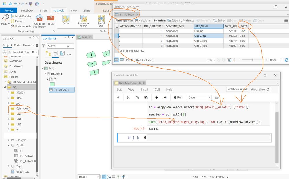

The name of the blob field is “data” but not “imageblob” as per the screenshot below.
The code manages to extract one of the photos! Why does it fail to extract all of them?
