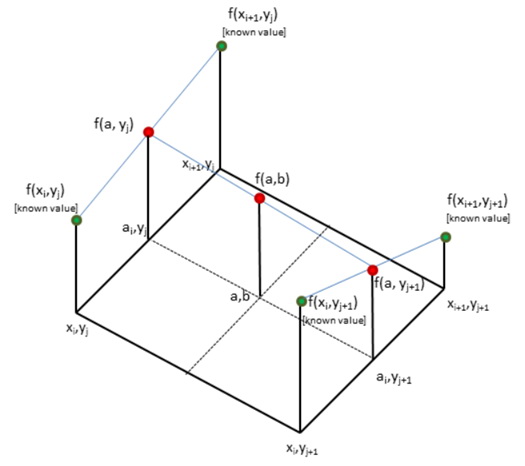

And why it is not simply an interpolation process that can be computed based on the set of known points?
