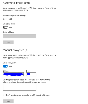

MarkMenzel1
Hi Chris,
I just had this issue and our virtual machines are connecting to the internet through a proxy. I found that in IE I could connect to the portal but not in Chrome or ArcGIS Pro.
The solution was to un-tick the Automatic Proxy settings in the system proxy configuration. This let us connect from ArcGIS Pro and also in Chrome. It does require that you have proxy settings from the IT department. Screen capture from our vm and its proxy settings.
Cheers,
Mark
