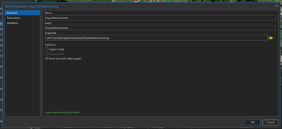

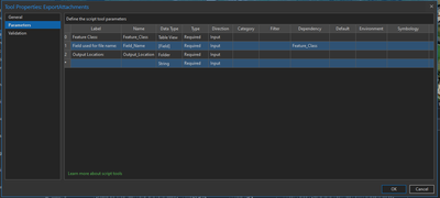

I checked for existence for inTable, attTable and joinTable. All exist, still no output. Running the script directly through IDLE heeds the desired results, but through ArcGIS I get nothing. Possibly a setting I have improperly configured? I have attached screenshots of my properties and parameters for the script.
