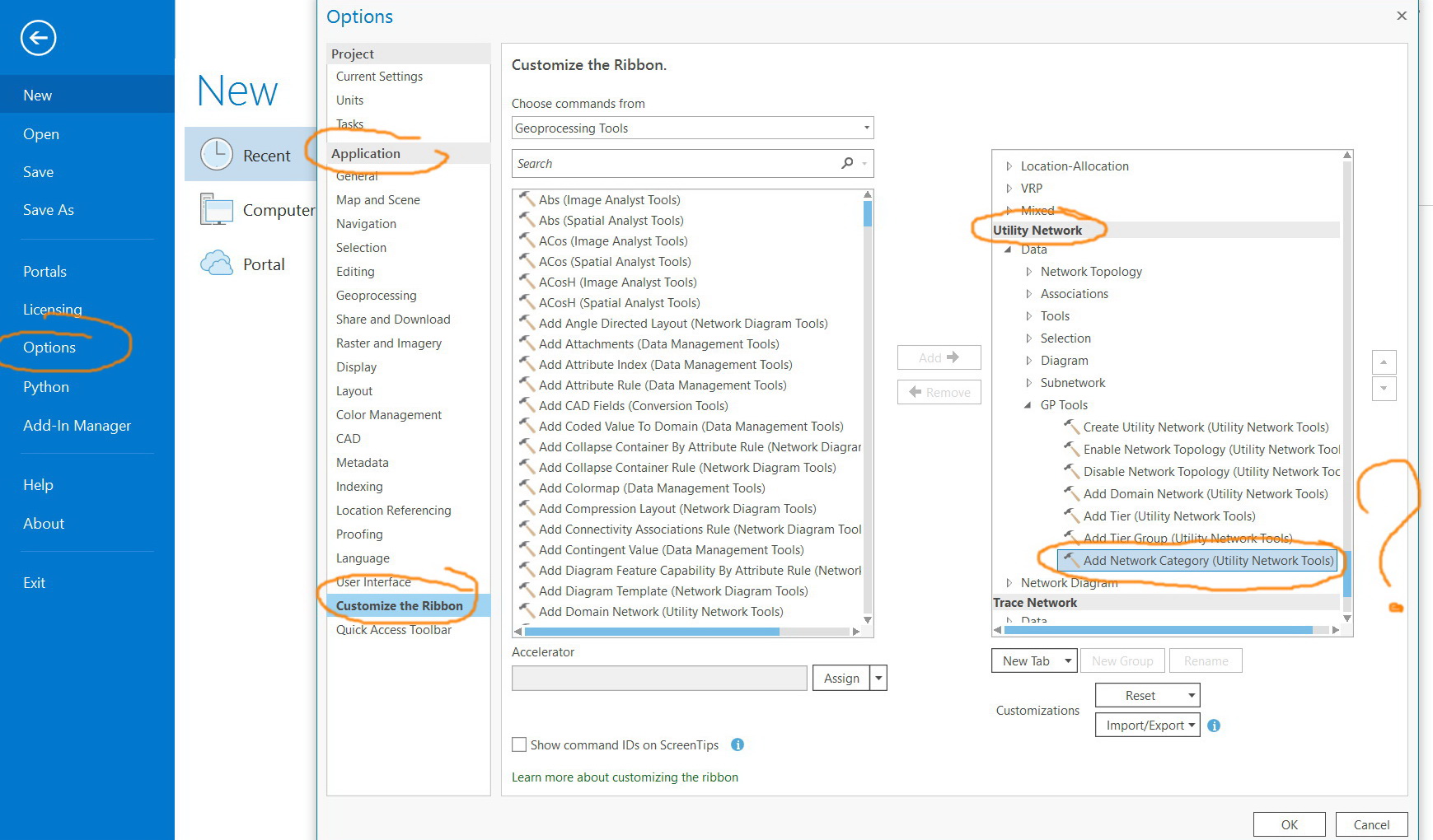

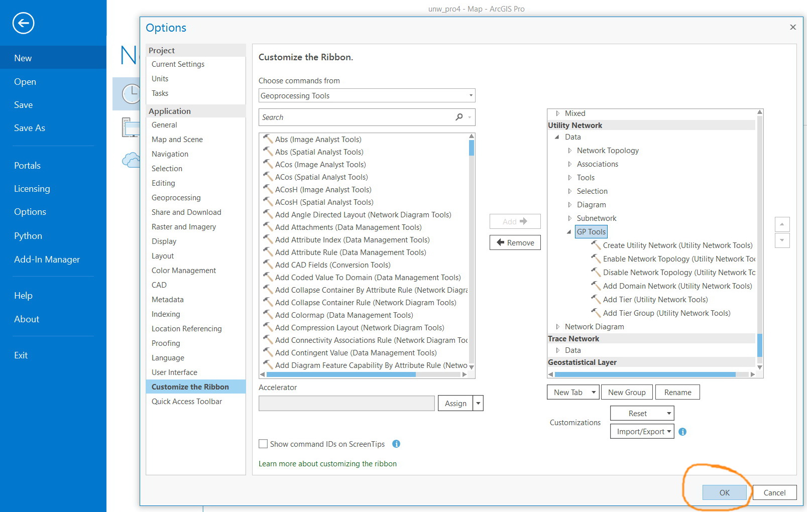

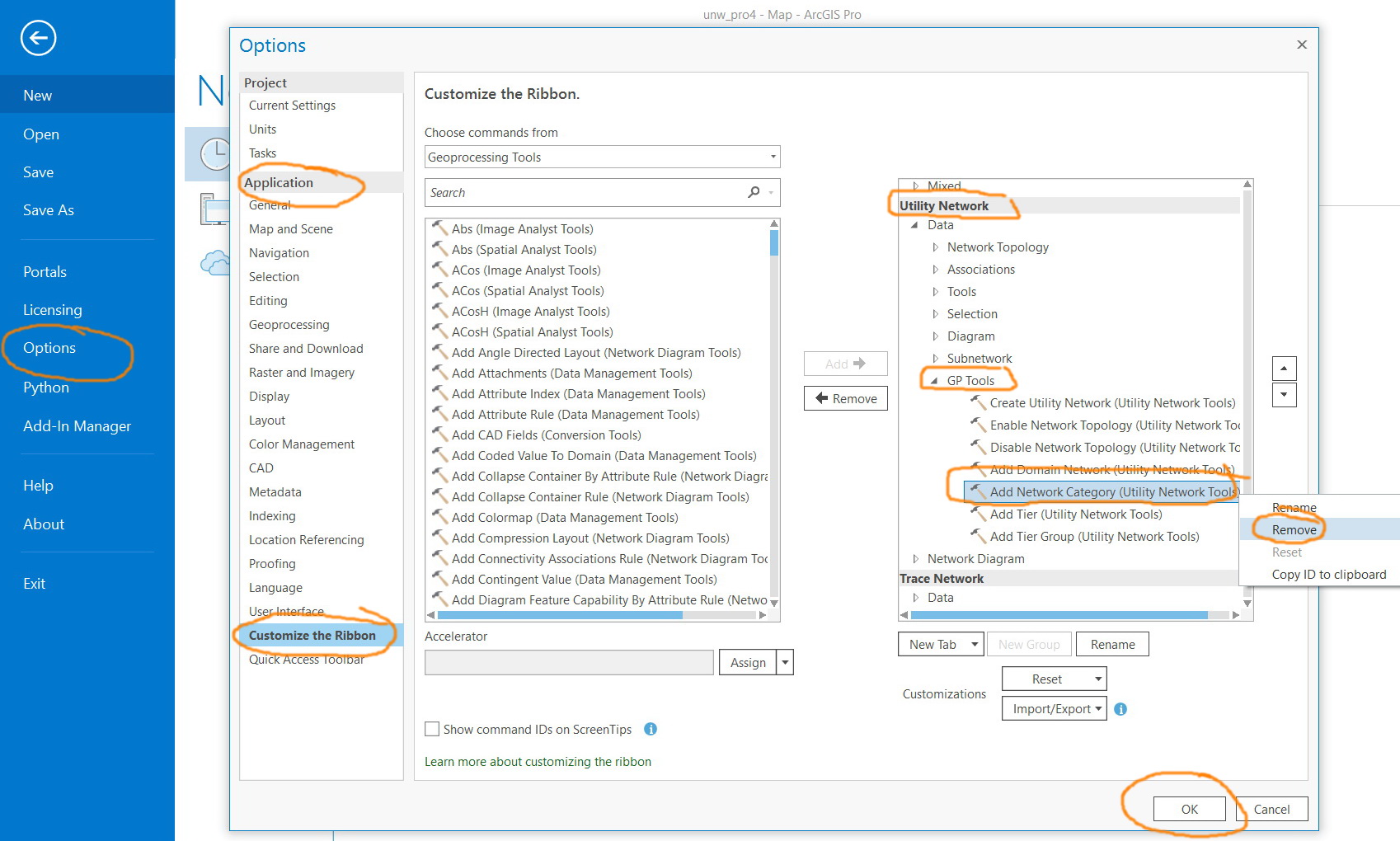

In the screenshot below, I wanted to remove the marked GP tool. It is selected and removed then “ok” is clicked. However, when revisiting the “customized ribbon” tab, I observed that the tool is still there!
Is this a bug?

I think "remove" applies to these circumstances
  • remove a command that you added to a new group.,
  • remove a group that you added to an existing tab or to a new tab
  • remove a new tab that you added.
and from the Note there
  • Removing a group removes all its commands.
  • Removing a tab removes all its groups.
Customize the ribbon options—ArcGIS Pro | Documentation

I removed the group and re-added the GP tools that I need. It works fine
