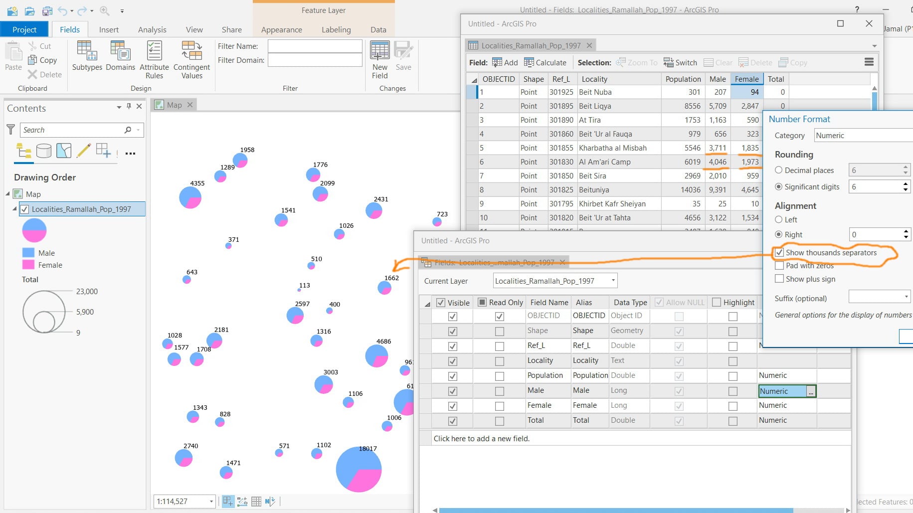

I couldn’t figure out how to show thousands separator on labels. In ArcMap, the format of labels respects the format of values in the attribute table. This is sounds not to be applicable in Pro

It works for me with the code below
text($feature.Female, '#,###')

You still can use the numbers formating  as the following, but don't forget to Save your edits to the fields
The result

It appears that labeling doesn’t respect the format the values have in the table in case of Join!
What could be the issue here?

I am having the same behavior here.
The workaround is to add an expression
Arcade:
Round($feature.Shape_Area,2)

To tack on to this one - I had to close and reopen the aprx for the commas to show in the label.
