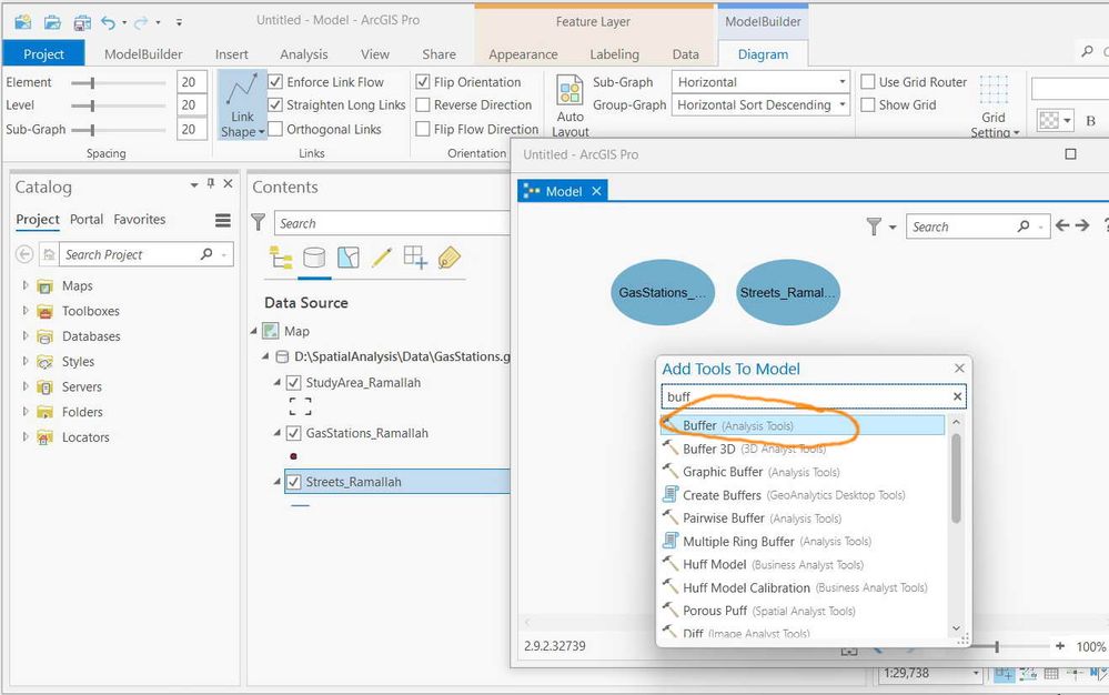

I couldn’t figure out how to get the added tool to the model builder canvas aligned vertically

In ArcMap, as the “top to bottom” option is selected, the tools added to model builder get vertically aligned.

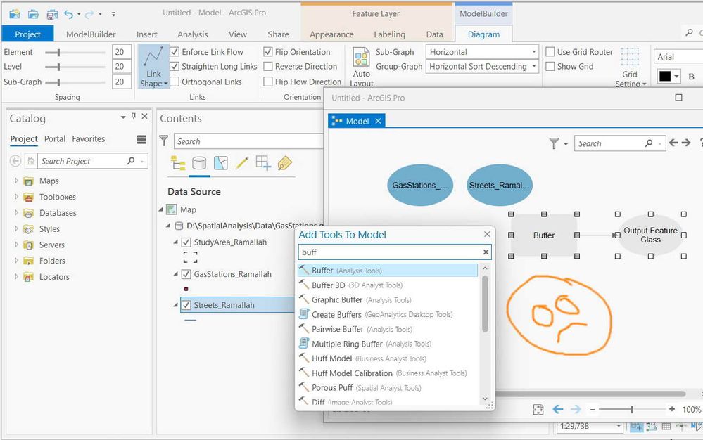

In Pro, they are horizontally aligned as they are added to the model builder

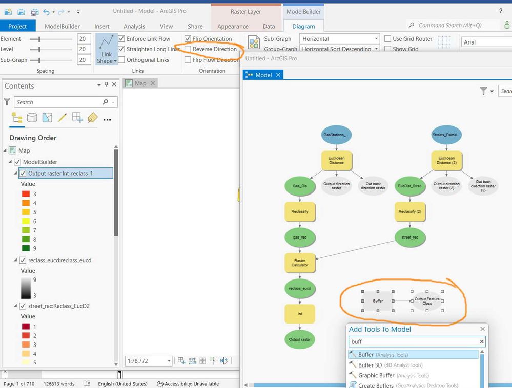

Jamal - this is currently correct when you initially add the GP tool.  BUT if you go to the ModelBuilder->Diagram tab, click the "Reverse Direction" box in the Orientation Group, then uncheck it, the GP tool does orient "top to bottom."  I have not seen ArcGIS Pro 3.0 yet but perhaps this behavior is improved in the soon to be released update!

What I wanted here is to have the exact behavior as it used to be in ArcMap. The tool is aligned vertically as it’s added with no need to check\uncheck the “reverse direction” option
