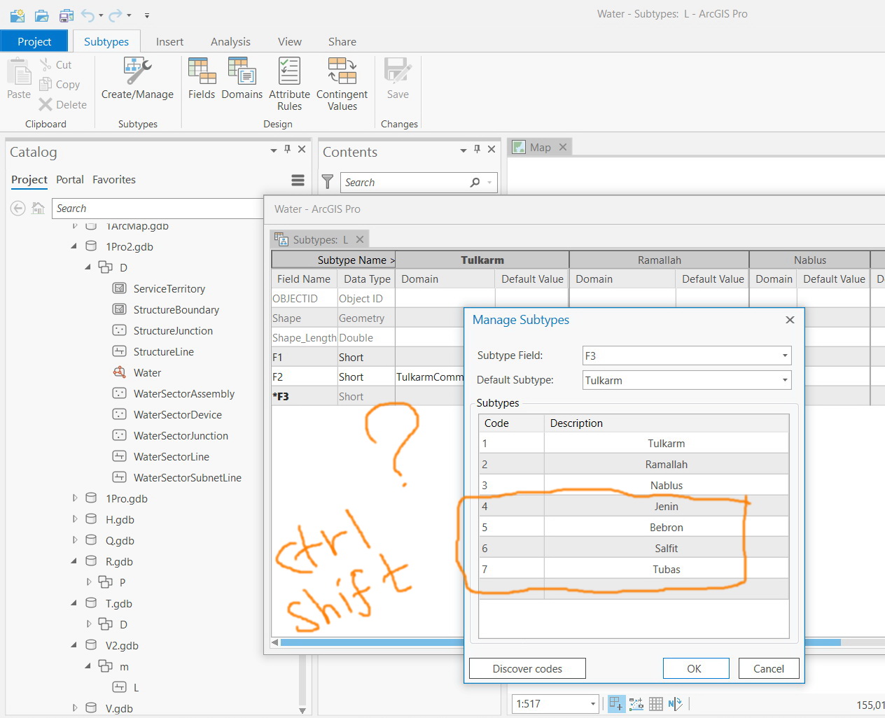

This should be easy but couldn’t figure out how to delete multiple subtypes
Jamal Numan

Multiple subtypes can be deleted at once by selecting more than one row using the Ctrl or Shift key.

Thanks Dan.
I’m not able to select multiple rows with ctrl or shift.
Jamal Numan
DanPatterson_Retired
MVP Emeritus
I don't see anything selected... If your image shows a selection, then something is wrong with the selection method (click on the number)
To check, select one row  and see if the row gets highlighted, then select ctrl OR shift (not both) and see if others get selected.  If the row doesn't select, then something is up

Hmm, yeah, I think that's the problem.  It doesn't look like it is possible to select multiple rows in the Manage Subtypes dialog.  I'll ping that team...

Hi Kory,
Is it documented as a bug?
Jamal Numan

Hi Jamal,
I am not able to find this bug documented anywhere, which means that it has not been reported to technical support.  I'm in contact with the development team so that they can look into it.  If you need a bug number to track, please contact Technical Support to log a bug.
