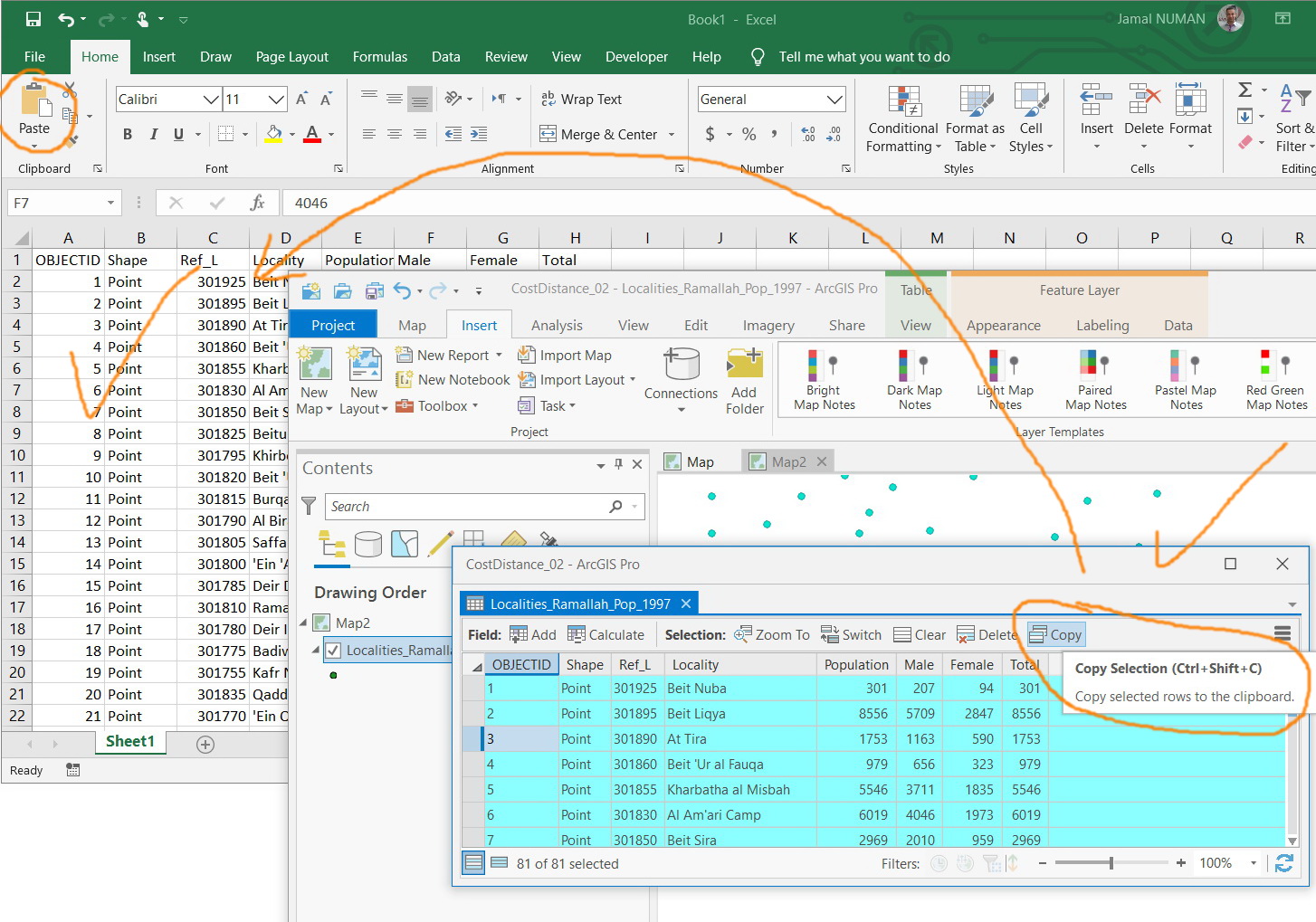

In ArcMap, one can select the entire attribute table, then “copy selected” and paste into excel. This tool appears not to be available
Jamal Numan
KoryKramer
Esri Community Moderator
Copy Selection has a button and the shortcut is Ctrl+Shift+C
JamalNUMAN
Legendary Contributor
Many thanks Kory. Right! It’s there!
