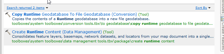

It appears that in this version of ArcGIS Pro the following  tools are not availble
*Copy runtime geodatabase to File Geodatabase
*Create runtime Content
I know ArcMap 10.5.1 is a different product - but is their an equivalent tool(s) we can use?
(The purpose is to recover Collector Databases that wont sync back to the device)
