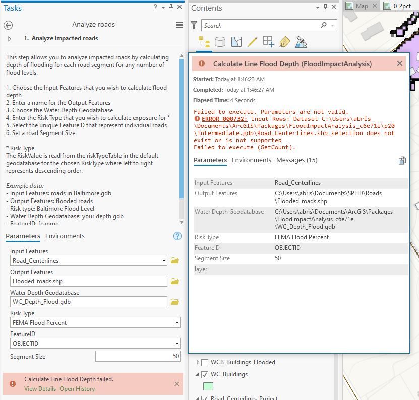

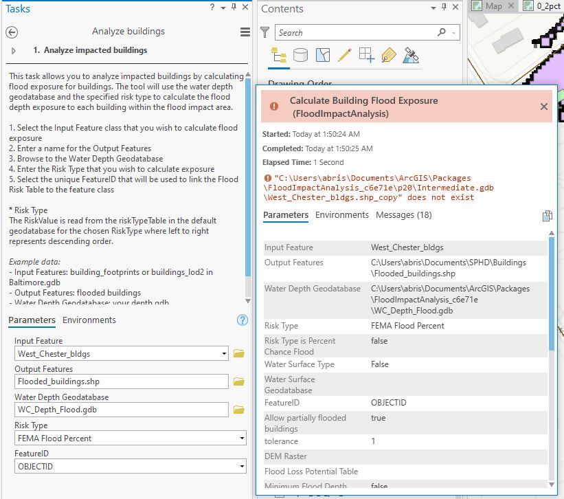

  • For both the Analyze Roads and Analyze Buildings steps, I am getting the following errors. I think this might have something to do with an invalid file path, but I'm not completely sure.
    Roads ErrorRoads ErrorBuildings ErrorBuildings Error

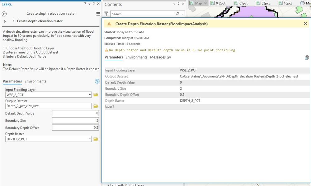

  • The second question I have is with creating the depth elevation rasters. The tool will run with warnings but doesn't create the depth elevation raster. I also get the same error whether I use a depth raster or not. Does anyone know what the correct inputs are for this tool?
    Creating Depth Elevation Raster ErrorCreating Depth Elevation Raster Error

I am seeing ".shp" in you inputs/outputs.
Use copy features and copy any features into a locally stored file geodatabase and skip shapefiles for the analysis.  This could account for the errors
... sort of retired...
AmandaBristowe
Hi Dan,
If both the roads and buildings layer I am using are shapefiles, how do I go about fixing that?
Thanks!
