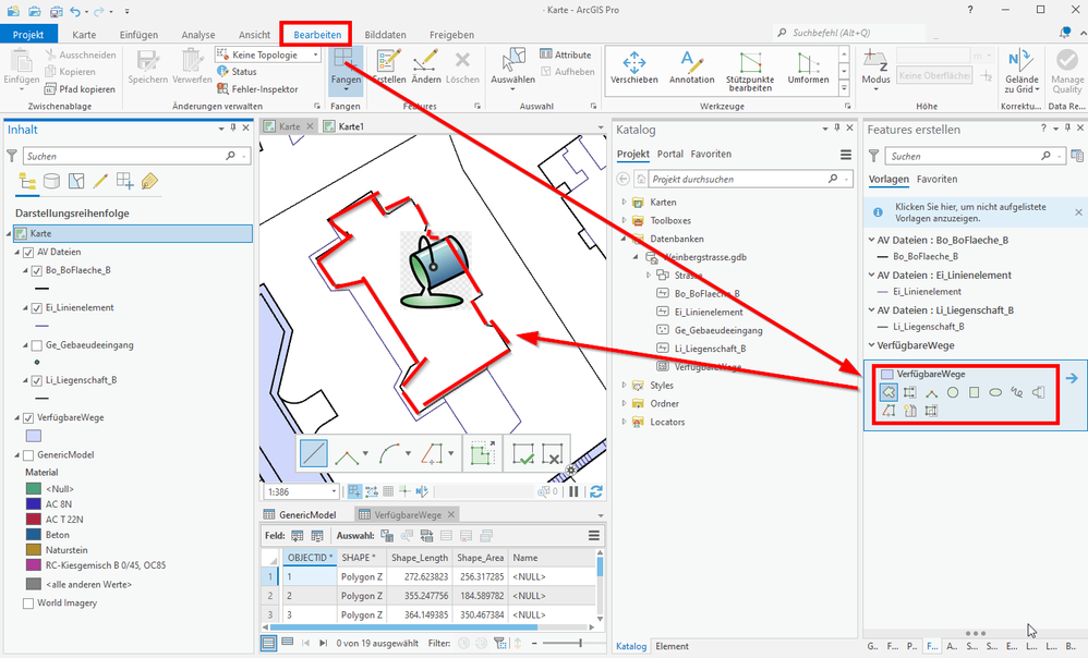

Hello, there is any tool to create polygons simply clicking in the center of group of closed lines, like the Paint tool "Bucket" in the basic license of ArcGIS Pro?
I know "follow"  AngelRomoSandoval_1-1664431519993.png but it is not so fast...
