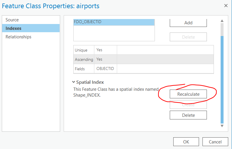

Maybe to the spatial index properties from the Catalog pane and recalculate the index:

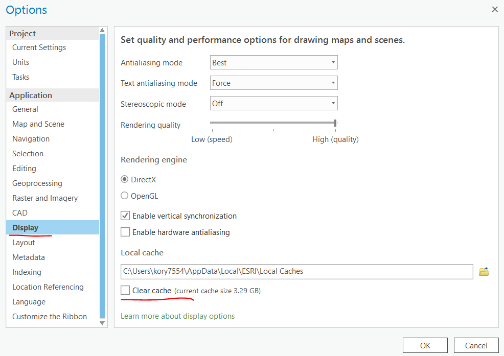

Otherwise, try clearing the cache:
More about How caching works—ArcGIS Pro | ArcGIS Desktop
