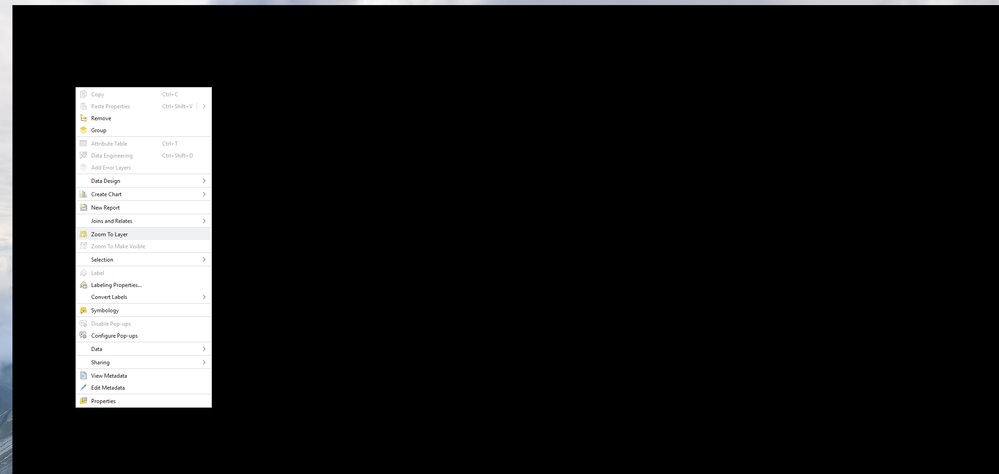

I uninstalled Pro this week and reinstalled it - now not only is it still not closing properly, it is getting hung up on simple clicks and tasks and the screen goes black. The table property window is also showing on top of every other window and won't close.
