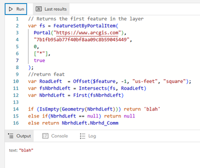

What do you get when you return RoadLeft? Your code seems to work in the Playground, returning the value for the IsEmpty check. That is expected, since I doubt the testing FeatureSet and $feature intersect at all

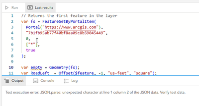

The reason you're getting "error0" is that the Geometry function expects a Feature, not a FeatureSet.  You'd have to loop through the FeatureSet to test each Feature.
var fsNbrhd =  FeatureSetByName($datastore, 'Neighborhood', ['Nbrhd_Comm'], true);
for (var f in fsNbrhd) {
  if (IsEmpty(Geometry(f))) return `Record ${f.OJBECTID) is empty";
return "No empty records";
 What's curious is that putting the FeatureSet in the Geometry function works in ArcGIS Pro but not in the Playground.

I did test your code using my data in ArcGIS Pro and it did run correctly.
