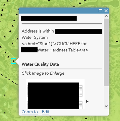

I have a Web Map that needs a popup that will return different URLs as hyperlinks depending on the different attribute field types.
Currently, I have an Expression based in Arcade script with IF-ELSE (multiple) that returns different TEXT based on the attribute in that cell. That works just fine.
What I need is to have two different URLs returned as well, based on that same set of criteria.

Is this an Arcade Popup Element or an attribute expression? you might need to return this as a rich text element instead of a simple string. To accomplish this instead of returning the variable where your text is stored by itself, return your result like this:
return {type : "text", text : output}

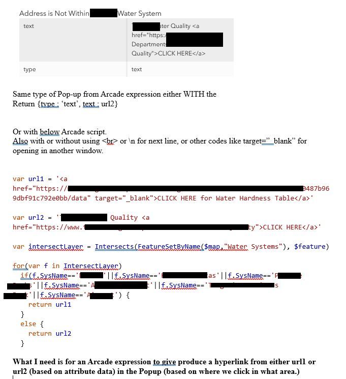

Teresa-AZ
Hi.  Well, thanks Austin, but that did not work either and I have literally attempted so many variations on the code and even make a separate Arcade expression for just the urls.  Also without variables and putting the url into the actual return line. I am at a loss.
What I need is for an Arcade expression to give produce a hyperlink from either url1 or url2 (based on attribute data) in the Popup (based on where we click in what area.)

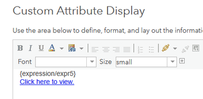

Thanks for your help! It is helpful AND I finally found a solution after much online research and looking back over my "Getting to Know Arcade" workbook and the Esri 2023 Arcade session!  Here is what I did...
I created an Expression for just the URLs:
var url1 = "https://xyz"
var url2 = "https://xyz"
var intersectLayer = Intersects(FeatureSetByName($map,"Water Systems"), $feature)
for(var f in IntersectLayer)
if(f.SysName=='xyz'||f.SysName=='xyz'||f.SysName=='xyz'||f.SysName=='xyz'||f.SysName=='xyz'||f.SysName=='xyz) {
return url1
else {
return url2
THEN I was able to add to my "custom attribute display..." Popup Content Configure box both the regular Expression I had and the new URL EXPRESSION AND make it a Hyperlink by using the Hyperlink icon and putting the New URL Expression into the "URL" box instead of a simple URL.  Yay!  Thanks, Austin et. al!

AustinAverill
Teresa-AZ
