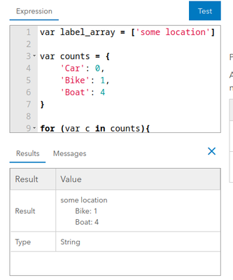

And here's me testing that with some sample values:

jcarlson
MVP Alum
Simple enough! We can use push to add entries to the array only when the condition is met.
var label_array = [$feature.LOCATION]
var counts = {
    'Car': $feature.CAR_count,
    'Bike': $feature.BIKE_count,
    'Boat': $feature.BOAT_count
for (var c in counts){
    if(counts[c]>0){
        Push(
            label_array,
            `\t${c}: ${counts[c]}`
return Concatenate(
    label_array,
    '\n'
