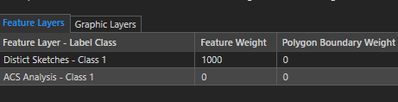

Everything else I can find will eliminate labels within a polygon, but not the inverse. Is the polygon layer something you can modify? If you turned it into a giant "donut", with the current shape being the "hole", you could use the Label Weight Ranking settings to exclude labels within that area.

@jcarlson Yes I can modify the polygon layer. If I cannot find anything else I will try that. Thanks!
