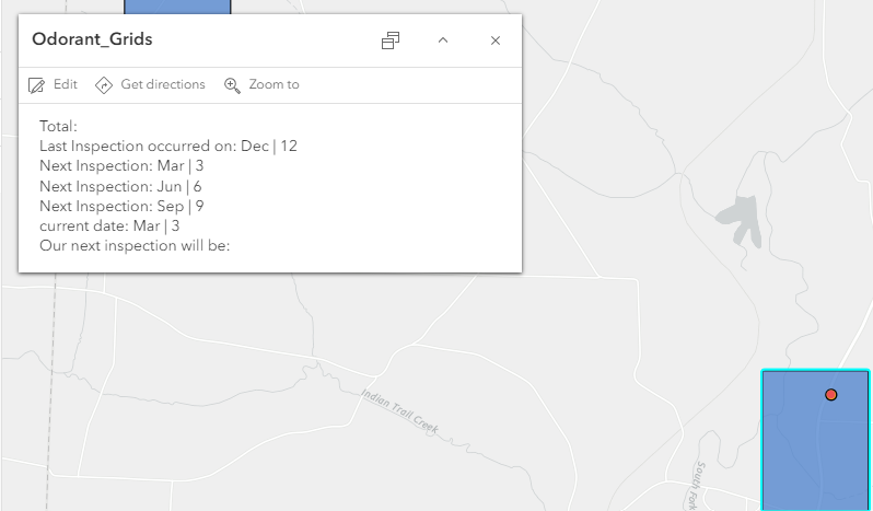

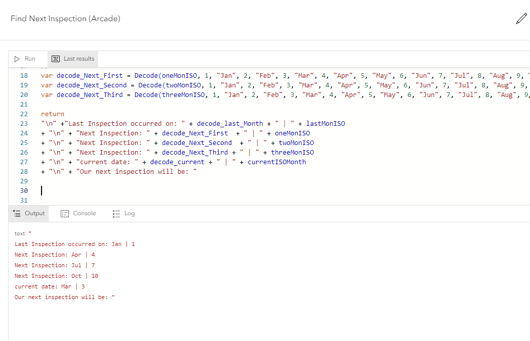

I have grids with a hardcoded last inspection date and an interval field specifying an inspection every 3 months. How can I calculate the next projected inspection date based on the current date and when the last inspection occurred? My objective is to provide just the upcoming projected inspection date going forward for every year.
// Get the current month based on today date;
var currentdate = Today();
var currentISOMonth = ISOMonth(currentDate);
// decode the month as an integer;
var decode_current = Decode(currentISOMonth, 1, "Jan", 2, "Feb", 3, "Mar", 4, "Apr", 5, "May", 6, "Jun", 7, "Jul", 8, "Aug", 9, "Sep", 10, "Oct", 11, "Nov", 12, "Dec", "missing data");
// Get the last inspection month (Show as a (Integer) value);
var lastinspectiondate = Date($feature.lastinspection);
var lastMonISO = ISOMonth(lastinspectiondate);
// Add projections for the rest of the year (Occurs ever 3 months)
var oneMonISO = When(lastMonISO + 3 < 12, lastMonISO + 3, lastMonISO - 12 + 3);
var twoMonISO = When(oneMonISO + 3 < 12, oneMonISO + 3, oneMonISO - 12 + 3);
var threeMonISO = When(twoMonISO + 3 < 12, twoMonISO + 3, twoMonISO - 12 + 3);
// Get the last inspection month (Show as a (Text) value);
var decode_last_Month = Decode(lastMonISO, 1, "Jan", 2, "Feb", 3, "Mar", 4, "Apr", 5, "May", 6, "Jun", 7, "Jul", 8, "Aug", 9, "Sep", 10, "Oct", 11, "Nov", 12, "Dec", "missing data");
var decode_Next_First = Decode(oneMonISO, 1, "Jan", 2, "Feb", 3, "Mar", 4, "Apr", 5, "May", 6, "Jun", 7, "Jul", 8, "Aug", 9, "Sep", 10, "Oct", 11, "Nov", 12, "Dec", "missing data");
var decode_Next_Second = Decode(twoMonISO, 1, "Jan", 2, "Feb", 3, "Mar", 4, "Apr", 5, "May", 6, "Jun", 7, "Jul", 8, "Aug", 9, "Sep", 10, "Oct", 11, "Nov", 12, "Dec", "missing data");
var decode_Next_Third = Decode(threeMonISO, 1, "Jan", 2, "Feb", 3, "Mar", 4, "Apr", 5, "May", 6, "Jun", 7, "Jul", 8, "Aug", 9, "Sep", 10, "Oct", 11, "Nov", 12, "Dec", "missing data");
return
"\n" +"Last Inspection occurred on: " + decode_last_Month + " | " + lastMonISO
+ "\n" + "Next Inspection: " + decode_Next_First + " | " + oneMonISO
+ "\n" + "Next Inspection: " + decode_Next_Second + " | " + twoMonISO
+ "\n" + "Next Inspection: " + decode_Next_Third + " | " + threeMonISO
+ "\n" + "current date: " + decode_current + " | " + currentISOMonth
+ "\n" + "Our next inspection will be: "
