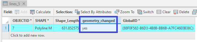

The attribute rule works as expected in most cases. For example, in the Edit Vertices window, if I manually change an X or Y coordinate using the keyboard, the field will be flagged as "yes", as expected.

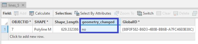

However, if I manually change the M-value in the Edit Vertices window using the keyboard, the field will be flagged as "no", which is not expected.

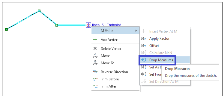

The same thing happens when I use the Drop Measures tool:
