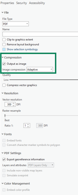

That has to do with the browser itself, I came across the same issue when exporting out PDFs and opening it in Adobe. Some labels are not readable in Adobe due to the software being not familiar with the font. Something that did help but might not solve all of your issues is when exporting out in pdf is making sure that the output as image under the compression is enabled. You can choose different types of image compression such as jpeg.  (If your office does a lot of text editing in the map, I don't recommend it). Hope this helps 🙂
tmo
Thanks for the tip. Once it is output as an image, have you noticed an issue with pixelation when zooming in tight on the pdf?

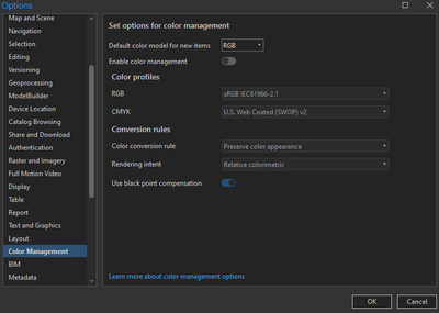

Exporting as a raster is an option, but you can also make sure your color profile setting are correct. You can globally set it in your options:
Then when exporting a PDF, if you have a color profile set, the Embed Color Profile box will be available:
Look into what profile you should use for your application, and if you have multiple users that need to export identical color profiles, you will need to make sure they all have the same one set in their Options.

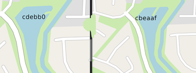

There is no guarantee that the PDF renderer will properly read your embedded profile. In my testing there were still small differences between Edge and Firefox. However, shipping a color profile with your PDF does mean that anyone who needs to have the original colors will be able to get them. Adobe products in particular will abide by the color profile.
Here's a comparison of Firefox (Right) and Edge (Left) using OSM basemap:
In ArcPro, the green is #cdebb0 so in this instance, Firefox was bang on. But the water colors all differed by a couple bits. This was with the "Preserve Values" flag set in my Color Management settings
