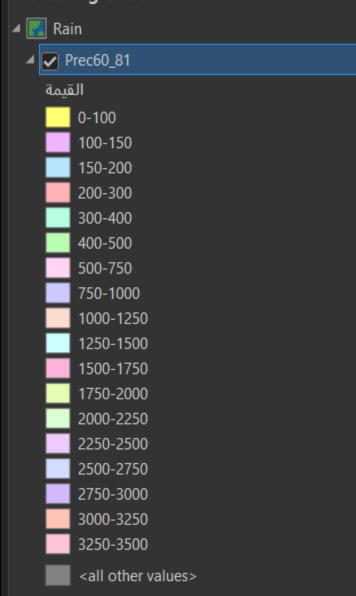

Hi everyone,
I'm working on a map in ArcGIS Pro and I'd like to remove the borders around each symbol within many classes of many feature classes(hug data set), essentially setting the border width to 0 pixels. Ideally, I'd like to avoid opening each symbol individually to make the change.
Are there any built-in tools or techniques in ArcGIS Pro to achieve this efficiently? Any suggestions or workarounds would be greatly appreciated!

In the Symbology window, click on the down arrow next to the word More.
That will open a pop-up window where you can then edit all symbols.

Hala_Ghareeb
it works, thank you
