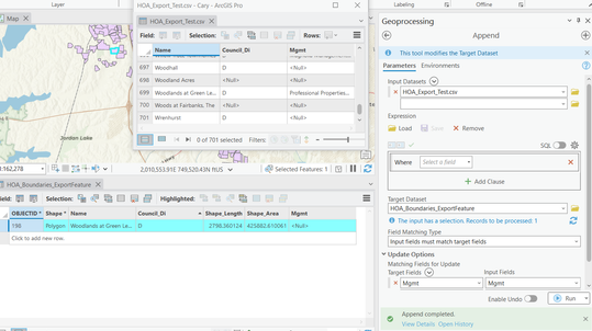

I am trying to update a layer in Pro with a table the has updated information. I am trying to use the Append tool. When I run the tool, the field remain <Null>. Should I be using the Append tool or something different?

You can't append a csv file to a featureclass.  You can use Join field

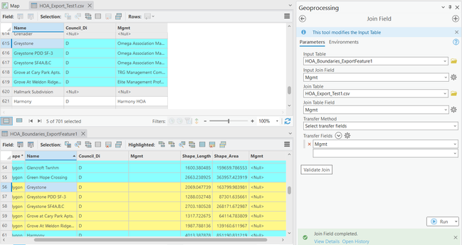

@DanPatterson Hi Dan - Thanks for you help with this. I ran the Join Field tool. It created a new field in my layer but the value is still <Null>. I've attached a screenshot. Do you see anything that I am doing wrong that it is always returning a <Null> value?

The Append tool is not suited for this task. It takes all features from one table and copies them to the second table. That is not what you want to do here.
As @DanPatterson suggested, Join Field could work. You can't get it to work because you need to join on a common field. That is "Name" in your case, but you're trying to join on "Mgmt".
