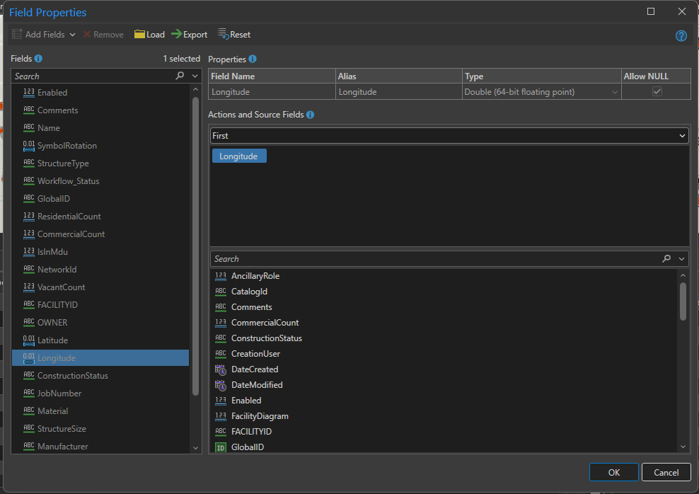

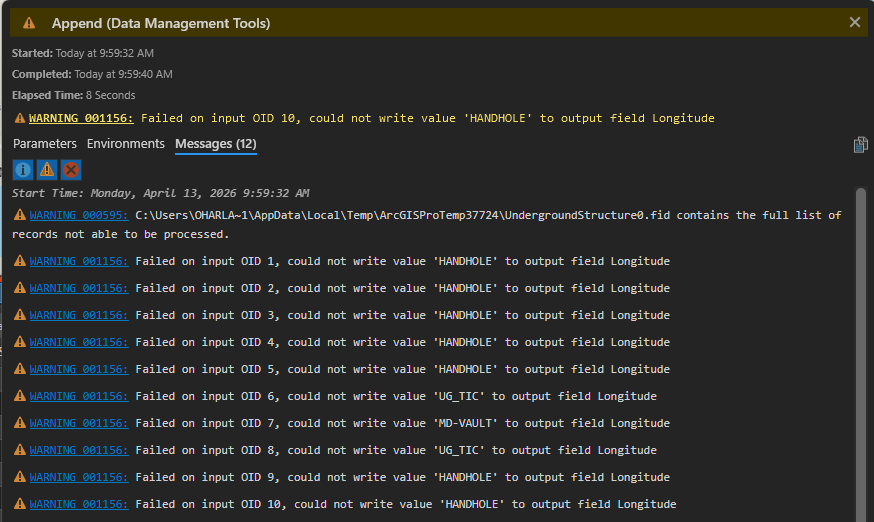

I recently encountered strange behavior upon attempting to append features from a FGDB to an AGOL Feature Service using the Append GP Tool. The two layer schemas do not match so I was using a field map to reconcile any differences. The tool then returned a set of warnings for each feature talking about how the value from one field in the input layer was not allowed in a different field in the target layer. (For example, it was warning about a value from a Type (TEXT) field not being able to be inserted into the Longitude (DOUBLE) field. These fields were not mapped together in the field map, but this warning went away when removing any mappings to the target layer's field. This is a new behavior that has only happened after the latest  bugfix release, and was not an issue last week. Running the append tool in arcpy with the schema_type parameter set to "NO_TEST" resulted in the features being appended correctly and without any warnings.

oharlacker_verita
The problem occured when the StructureType field of the input layer was mapped to the StructureType field of the target layer and the Longitude of the input was mapped to the Longitude of the target. When all mappings were removed from the Longitude field, it no longer showed a warning about Longitude, but still showed a warning about a different field having the same issue. Resetting the field map resulted in the same mapping string.
The field map string from that specific tool run is:
# Raw string directly from copy command:
field_mapping=r'Enabled "Enabled" true true false 0 Long 0 0,First,#,C:\Users\oharlacker\Documents\Projects\WOW\Append_Issues\GIS\Port A.gdb\UndergroundStructure,Enabled,-1,-1;Comments "Comments" true true false 255 Text 0 0,First,#,C:\Users\oharlacker\Documents\Projects\WOW\Append_Issues\GIS\Port A.gdb\UndergroundStructure,Comments,0,254;Name "Name" true true false 255 Text 0 0,First,#,C:\Users\oharlacker\Documents\Projects\WOW\Append_Issues\GIS\Port A.gdb\UndergroundStructure,Name,0,254;SymbolRotation "RotationAngle" true true false 0 Double 0 0,First,#,C:\Users\oharlacker\Documents\Projects\WOW\Append_Issues\GIS\Port A.gdb\UndergroundStructure,SymbolRotation,-1,-1;StructureType "StructureType" true true false 50 Text 0 0,First,#,C:\Users\oharlacker\Documents\Projects\WOW\Append_Issues\GIS\Port A.gdb\UndergroundStructure,StructureType,0,49;Workflow_Status "WorkflowStatus" true true false 25 Text 0 0,First,#,C:\Users\oharlacker\Documents\Projects\WOW\Append_Issues\GIS\Port A.gdb\UndergroundStructure,Workflow_Status,0,24;GlobalID "GlobalID" true true false 38 Text 0 0,First,#,C:\Users\oharlacker\Documents\Projects\WOW\Append_Issues\GIS\Port A.gdb\UndergroundStructure,GlobalID,-1,-1;ResidentialCount "ResidentialCount" true true false 0 Long 0 0,First,#,C:\Users\oharlacker\Documents\Projects\WOW\Append_Issues\GIS\Port A.gdb\UndergroundStructure,ResidentialCount,-1,-1;CommercialCount "CommercialCount" true true false 0 Long 0 0,First,#,C:\Users\oharlacker\Documents\Projects\WOW\Append_Issues\GIS\Port A.gdb\UndergroundStructure,CommercialCount,-1,-1;IsInMdu "IsInMdu" true true false 0 Long 0 0,First,#,C:\Users\oharlacker\Documents\Projects\WOW\Append_Issues\GIS\Port A.gdb\UndergroundStructure,IsInMdu,-1,-1;NetworkId "NetworkId" true true false 38 Text 0 0,First,#,C:\Users\oharlacker\Documents\Projects\WOW\Append_Issues\GIS\Port A.gdb\UndergroundStructure,NetworkId,-1,-1;VacantCount "VacantCount" true true false 0 Long 0 0,First,#,C:\Users\oharlacker\Documents\Projects\WOW\Append_Issues\GIS\Port A.gdb\UndergroundStructure,VacantCount,-1,-1;FACILITYID "FACILITYID" true true false 255 Text 0 0,First,#,C:\Users\oharlacker\Documents\Projects\WOW\Append_Issues\GIS\Port A.gdb\UndergroundStructure,FACILITYID,0,254;OWNER "OWNER" true true false 100 Text 0 0,First,#,C:\Users\oharlacker\Documents\Projects\WOW\Append_Issues\GIS\Port A.gdb\UndergroundStructure,OWNER,0,99;Latitude "Latitude" true true false 0 Double 0 0,First,#,C:\Users\oharlacker\Documents\Projects\WOW\Append_Issues\GIS\Port A.gdb\UndergroundStructure,Latitude,-1,-1;Longitude "Longitude" true true false 0 Double 0 0,First,#,C:\Users\oharlacker\Documents\Projects\WOW\Append_Issues\GIS\Port A.gdb\UndergroundStructure,Longitude,-1,-1;ConstructionStatus "ConstructionStatus" true true false 20 Text 0 0,First,#,C:\Users\oharlacker\Documents\Projects\WOW\Append_Issues\GIS\Port A.gdb\UndergroundStructure,ConstructionStatus,0,19;JobNumber "JobNumber" true true false 50 Text 0 0,First,#,C:\Users\oharlacker\Documents\Projects\WOW\Append_Issues\GIS\Port A.gdb\UndergroundStructure,JobNumber,0,49;Material "Material" true true false 50 Text 0 0,First,#,C:\Users\oharlacker\Documents\Projects\WOW\Append_Issues\GIS\Port A.gdb\UndergroundStructure,Material,0,49;StructureSize "StructureSize" true true false 50 Text 0 0,First,#,C:\Users\oharlacker\Documents\Projects\WOW\Append_Issues\GIS\Port A.gdb\UndergroundStructure,StructureSize,0,49;Manufacturer "Manufacturer" true true false 50 Text 0 0,First,#,C:\Users\oharlacker\Documents\Projects\WOW\Append_Issues\GIS\Port A.gdb\UndergroundStructure,Manufacturer,0,49;Model "Model" true true false 50 Text 0 0,First,#,C:\Users\oharlacker\Documents\Projects\WOW\Append_Issues\GIS\Port A.gdb\UndergroundStructure,Model,0,49;MDUCount "MDUCount" true true false 0 Long 0 0,First,#,C:\Users\oharlacker\Documents\Projects\WOW\Append_Issues\GIS\Port A.gdb\UndergroundStructure,MDUCount,-1,-1;Market "Market" true true false 255 Text 0 0,First,#,C:\Users\oharlacker\Documents\Projects\WOW\Append_Issues\GIS\Port A.gdb\UndergroundStructure,Market,0,254'
