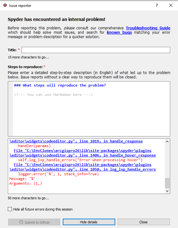

I can't recall how many times I've cloned python environments for ArcGIS pro and then added packages to them, but, this one takes the cake.
Using the ArcGIS pro package mis-manager I install spyder 3.something and spyder kernel 1.9.2 and upon launching spyder I get the 'Spyder has encountered an internal problem' window, telling me:
plugin = mod.PLUGIN_CLASS(self)
AttributeError: '_ModuleMock' object has no attribute 'PLUGIN_CLASS'
Well cowboy, this isn't my first rodeo (see _ModuleMock object has to attribute 'PLUGIN CLASS'  for example) so I open a python command window in my new clone and run
conda update spyder
But, after that the sh## storm really starts.  I get another internal problem window with so many issues, I can't believe my eyes:
Here is the full list:
  File "C:\EnvClones\arcgispro26\lib\site-packages\spyder\plugins\editor\widgets\codeeditor.py", line 1393, in handle_hover_response
    self._request_hover_clicked)
TypeError: CodeEditor.sig_display_object_info[str, bool].emit(): argument 1 has unexpected type 'list'

I've wiped my previous environments (I'll remember what other package dependencies I need to fix tomorrow when my over night scripts fail).  I get the same lengthy list of issues if I do a straight conda install for spyder.
And to think everything was going so well today too....
Suggestions? I guess I could uninstall ArcGIS Pro entirely, and reinstall, but then what's the point in 'upgrading'?
