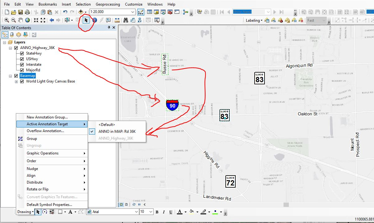

In Desktop, I used to be able to use the 'Select Elements' tool copy features from an annotation feature class and paste into an annotation group stored in the map.  This was super helpful since our base annotation layers though helpful, needed to be further arranged specifically for each map and therefore always needed to be copied into a mxd's annotation layer and arranged to meet the map's need.
I'm trying to replicate this process in Pro and I can't seem to find a way to do.  The only way to select a feature class annotation feature is to use the select features pointer.  There doesn't seem to be a select tool that will recognize both FC Annotation and graphic elements like desktop.
