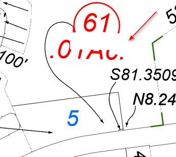

Is it possible to set the draw order or priority for Annotation classes? We have a class of parcel number annotations that are a half circle with a white box underneath (probably not the best but it's what we've got for now), and they cover up other annotations. It doesn't seem to be consistent, but is there a way to prevent this, maybe by forcing them to draw under other annotation classes?

That's a really cool use! Unfortunately I just tried and it didn't seem to work for me. I have two annotations that were overlapping (just like the screenshot in my original post), and changed the acreage ZOrder to 1. Then I changed the parcel number ZOrder to 0, applied the change, and when the map updated it was covering up the acreage. I then changed the parcel number ZOrder to 2, applied the change, but it was still covering the acreage.
