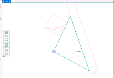

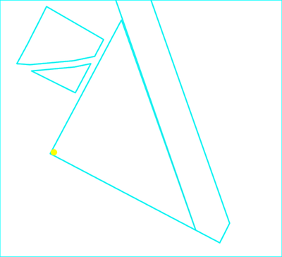

Yes, I have same issue in Pro 2.8.3  When moving a single entity, the anchor snaps to a point, but when I attempt to move multiple features together, the anchor will not snap to a point like first user noted. Snapping is on and layer is projected.  However, after looking at comment above, I changed my Map coordinate system to same as feature's coordinate system and it appears to be working.  I can't understand this behavior because why would the single move work?  Shouldn't this work without having to change my Map coord system?  In any case, I am happy it is working now!
singlefeature_move_anchor_showing_snapped
multifeature_move_anchor_showing_unsnapped
