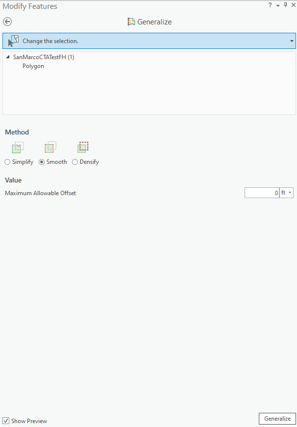

LoriHatfield1
I found the smooth tool under the generalize editing tool if this helps.  I could not run the smooth geoprocessing tool because of licensing.
Go to Edit > Select Modify (Features) > Select Generalize (located in Reshape Tools) > Choose Smooth Method (there are three available methods) > Select your polygon
Once you select your polygon you will be able to see a preview of how the generalize (smooth) tool will affect the selected polygon.
jmaxwell_braun
Thanks! This should be marked as the solution on this thread.
