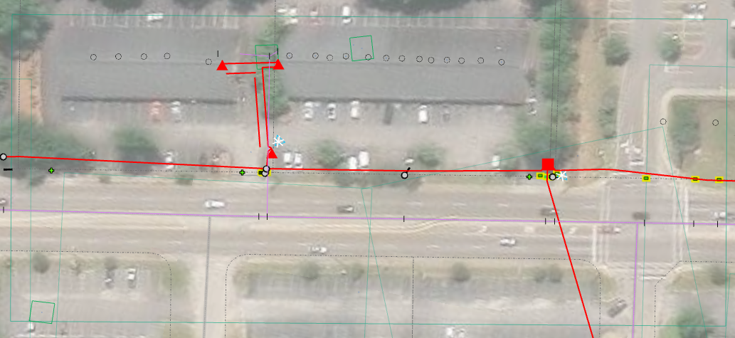

I have a series of point features where the symbology has been set up to rotate based on a field.  My client wants these Red Triangles to always point at the road.  This works for most situations but on larger projects I end up with situations like this...
On this sheet the Red Triangles are pointing to the road as intended, but...

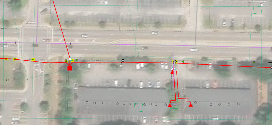

There is another page in the Map Series that shows this area, from a different angle.  But now the points are no longer pointing at the road.

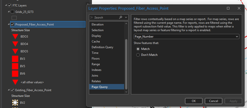

Since the Red Triangles were purely visual and had no data relevant to my tables, I added in duplicate point on top of the originals.  Then after setting up a field in the Red Triangles to store what page of the Map Series each one was on I updated the duplicate points to display the alternate page of the Map Series (ie the original ones were set to 3 and the duplicate ones were set to 13)
This is the bit of Arcade I used in the Field Calculator to do that for me:
var polygons = FeaturesetByName($datastore, "MapCuts")
var i_polygon = First(Intersects(polygons, $feature))
if(i_polygon == null) { return null }
return i_polygon.Sheet_Number
Then I added a copy of the Red Triangle feature layer to the map and set up Page Query in the layer properties to only display when the new Map Series field matches the active Page Number.
This made it so on Page 3 the original points displayed facing the road with the Page 13 points hidden
Then on page 13 the original points displayed facing the road with the original points hidden.
