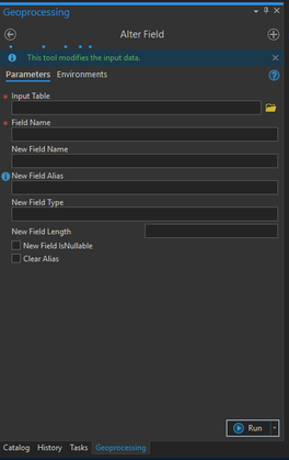

I'm not trying to alter field nullability, but I don't have the option to change that. I closed and reopened Alter Field several times and saw that below, for the first 1-2 seconds the window appears as on the left. Then the New Field is Nullable and New Field Type parameters disappear. Does anyone else have this issue?

Right. But I'm not trying to alter the Field Nullability. ArcGIS thinks I am because by default the New Field is Nullable box is unchecked -- and my feature class does allow null values. But like illustrated in my post, that parameter disappears when loading the tool so I can't change it.
