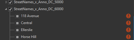

DnyaneshDeshpande
Yes, that error is for the annotation layers themselves. In particular each of the annotations in the annotation layer.
Scott_Harris
Ah I see... that seems like this bug that was fixed in 2.8:
noted here: https://pro.arcgis.com/en/pro-app/latest/get-started/release-notes.htm
However, with that bug, you should still be able to edit the annotation, so I'm not sure why Align isn't working for you. Esri Technical Support can help give you a faster answer, but upgrading to 2.8 might be a good starting point.
