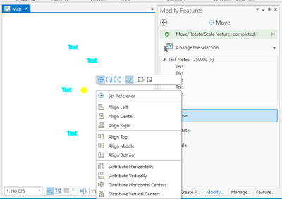

use the Align and Distribute commands that appear when you right-click  on the map when the Move tool is open. More info here: https://pro.arcgis.com/en/pro-app/latest/help/editing/align-or-distribute-features.htm
  1. Modify features pane > Move
  2. Select the features
  3. Right-click on the map and choose the appropriate command.
Does that help?

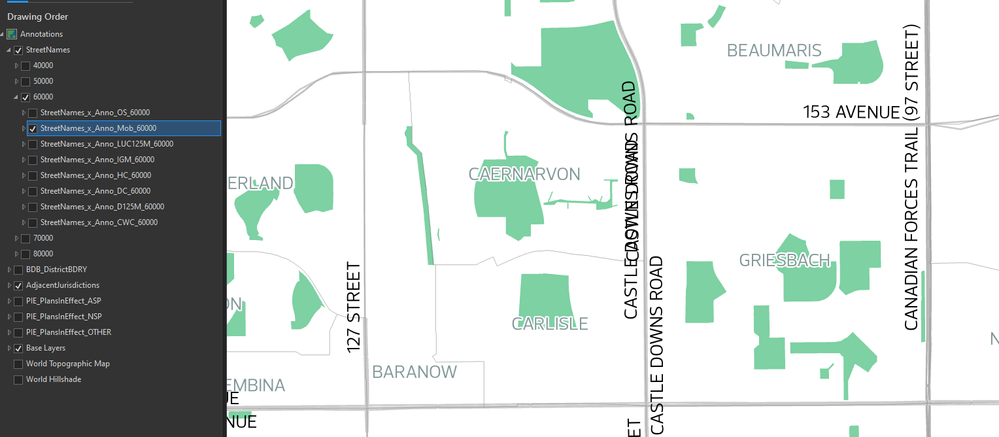

Thanks I did try that at one point but the commands don't affect my annotations. They are annotations not linked to a feature class. I'm not sure if this works on this type of annotation or not, maybe I have something not correctly configured?
DnyaneshDeshpande
Here is an example, I want to align all the Castledown Road annotations so they are on top of each other. You can also see the layer structure where there are multiple annotations in a single layer

I think what "may" be happening is your HorizontalAlignment attribute field is set to something other than "Left."  Select the annotations is question and change the HorizontalField attribute to Left for all the features and then use Scott's workflow.  I should work as expected based upon my testing.
DnyaneshDeshpande
Thanks for the suggestion! I looked and they were set to Center in the HorizontalAlignment filed. I changed them to left but the alignment options still don't seem to be having any effect at all on the annotations. Still puzzled by what is stopping them from moving in this situation. Does it matter that these are in different feature classes?
